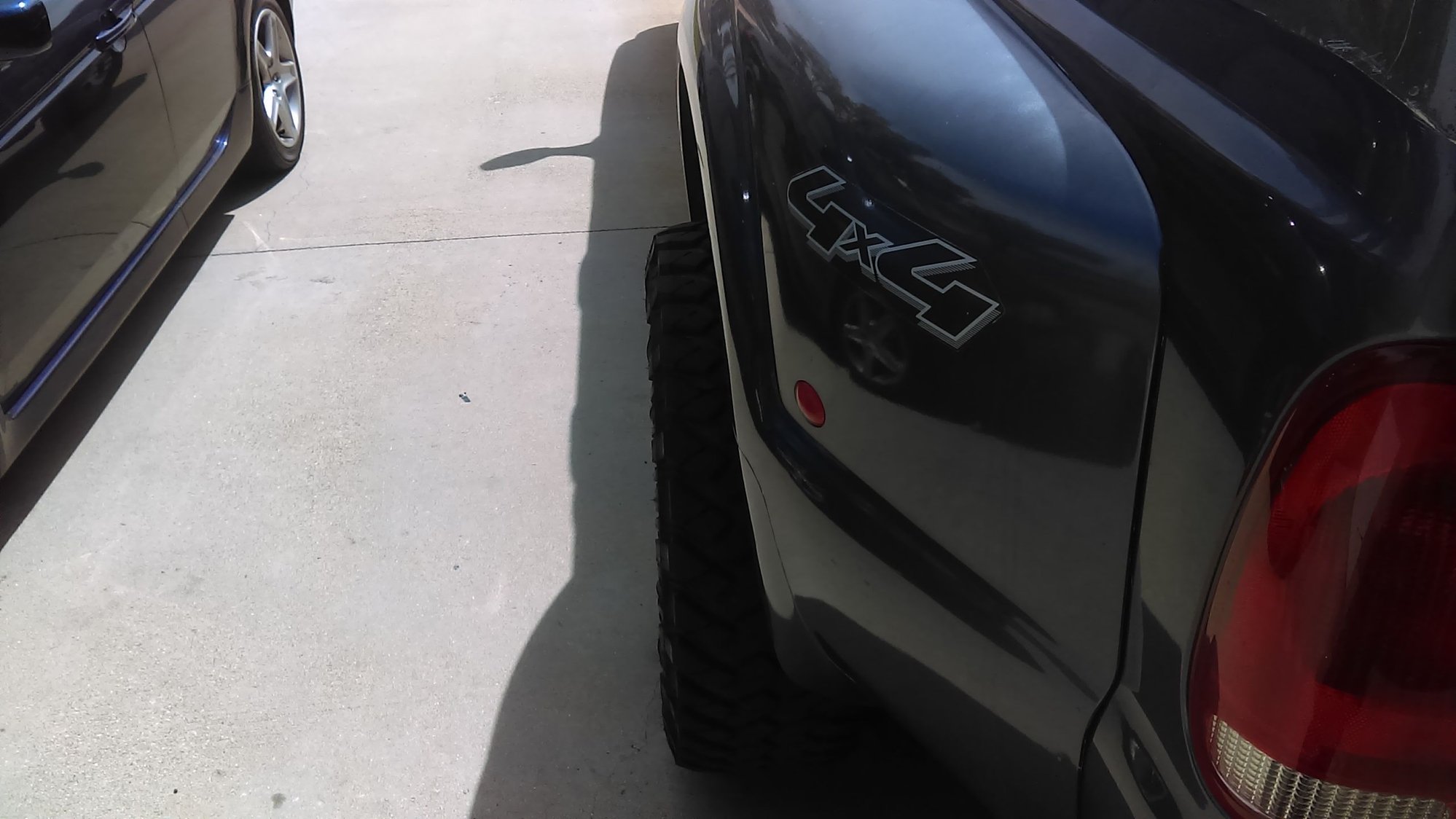

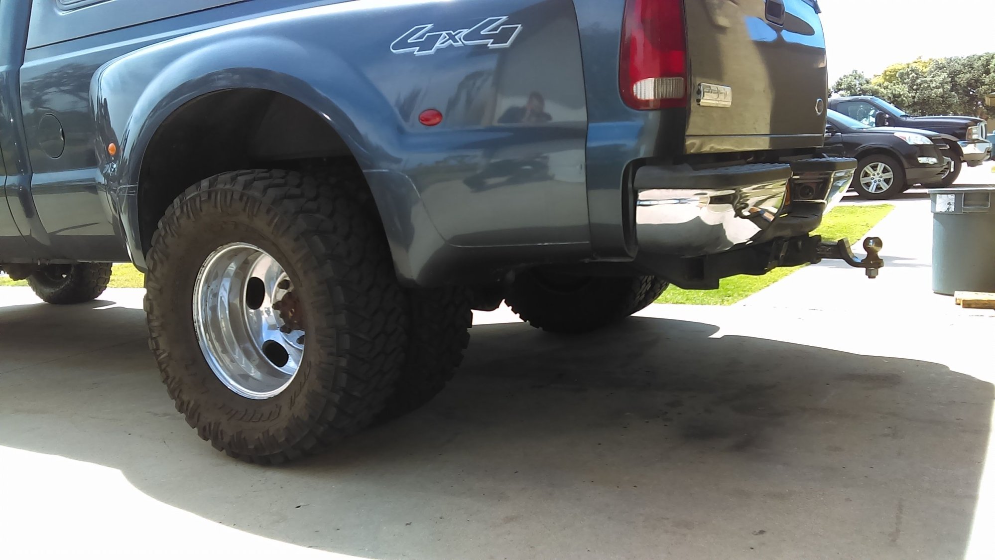

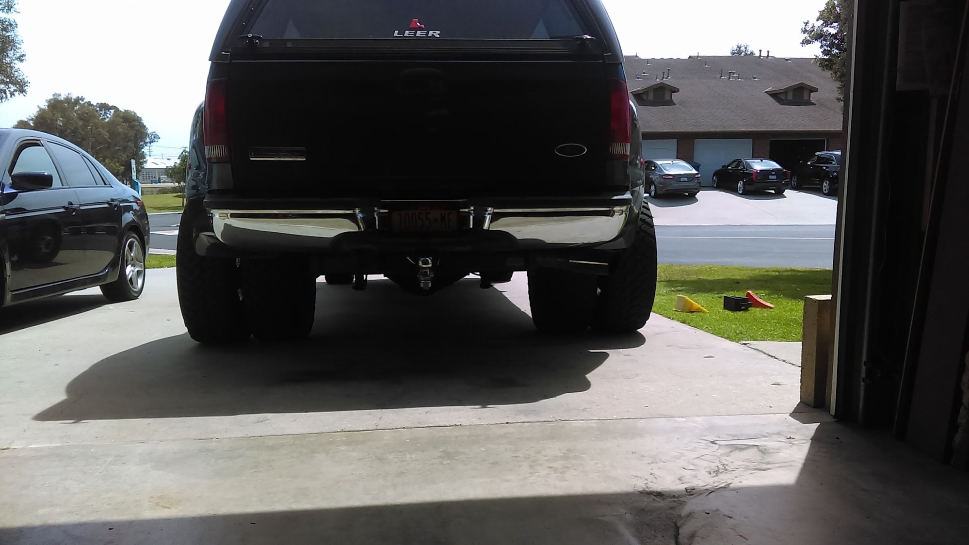

i know you got everything installed and done, but i just took this pic today, i texted you but i figured i'd post it for people that may read this thread in the future. after all the discussion about spacers we had, i definitely would feel more comfortable with hub centric spacers rather than the ones i have now. you can see the small gap in between the hub and my wheel, so the pressure on the outer wheels are being put on the studs, and aftermarket studs at that. so far i haven't had any issues, but i have contacted the guy that made these for me (semi local small custom shop) telling him i want HC spacers. i did actually request HC from the beginning, i still have my text messages to him as proof, but i think he will make things right. either way i will be switching mine to hub centric for peace of mind.
these are currently 2" spacers, i think i may go with 3" spacers when i get the new ones. Irish's dually is an 05, so his stock wheels i think are 1/2" maybe 1" wider than my stock wheels on my 04, so his slightlystock wider wheels and (i think) 305/70/17's with 2" spacers looks (waiting for measurements from him via text message) the same if not sticking out a tad MORE than my 315/75/16s with 2" spacers. once i see how much his sticks out compared to mine (shown in the 2nd pic below) will determine if i go with 2 or 3" spacers. us Florida boys like our super wide wheels/stance on our trucks haha. if you don't believe me, just google a few pics from Florida Forgiato Fest in miami! lmao!!!
I can measure my setup like yours to give you the exact idea. However my stock 17" rims are 6.5" wide and my tires I'm running now are 35x12.5x17. Not the 305's you mentioned about just for clarity.

weird, a few people have been having issues with not getting my texts/me not getting theirs. i will re-send what i sent today. i try to wait til at least noonish my time so i don't message you too early haha.
and yea if you can measure the front like that, that's essentially what the texts were about.
for some reason i thought you had 305s, we've talked about so many different spacers and tires lately i got confused haha. so yea, your tires are a little wider (mine technically are 34.6 x 12.4 x 16) and i believe my wheels are 6", so between that little bit of extra width, i think your rear setup may stick out an inch more than mine when measured that way. maybe not though, who knows lol
