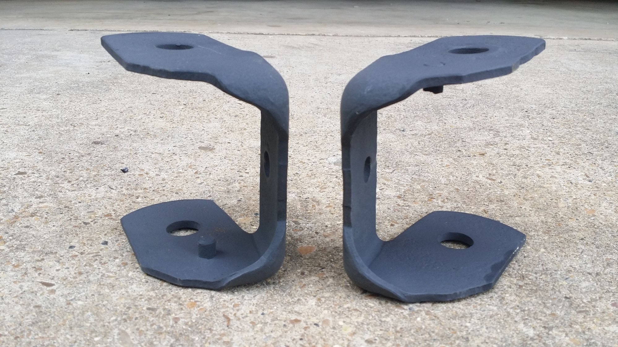

Hmmm. With a stock '71 F100 front suspension, I'm not sure how well a factory '75-'79 F100 - F350 front sway bar endlink bracket (C-bracket) will work with the stock '71 radius arms (?).
The factory forward-mounted sway bar was available for all '75-'79 F100s through F350s but, it wasn't installed on all the trucks. On the '75-'79 radius arms, they had a protrusion with a notch in it. There's a pin on the C-brackets that engages with these notches.
The radius arms on the Bumpsides don't have this protrusion on the forward ends of the radius arms and so, there's no material there to make a notch in them for the locating pins on the C-brackets.
The swaybar endlink C-brackets look like this.

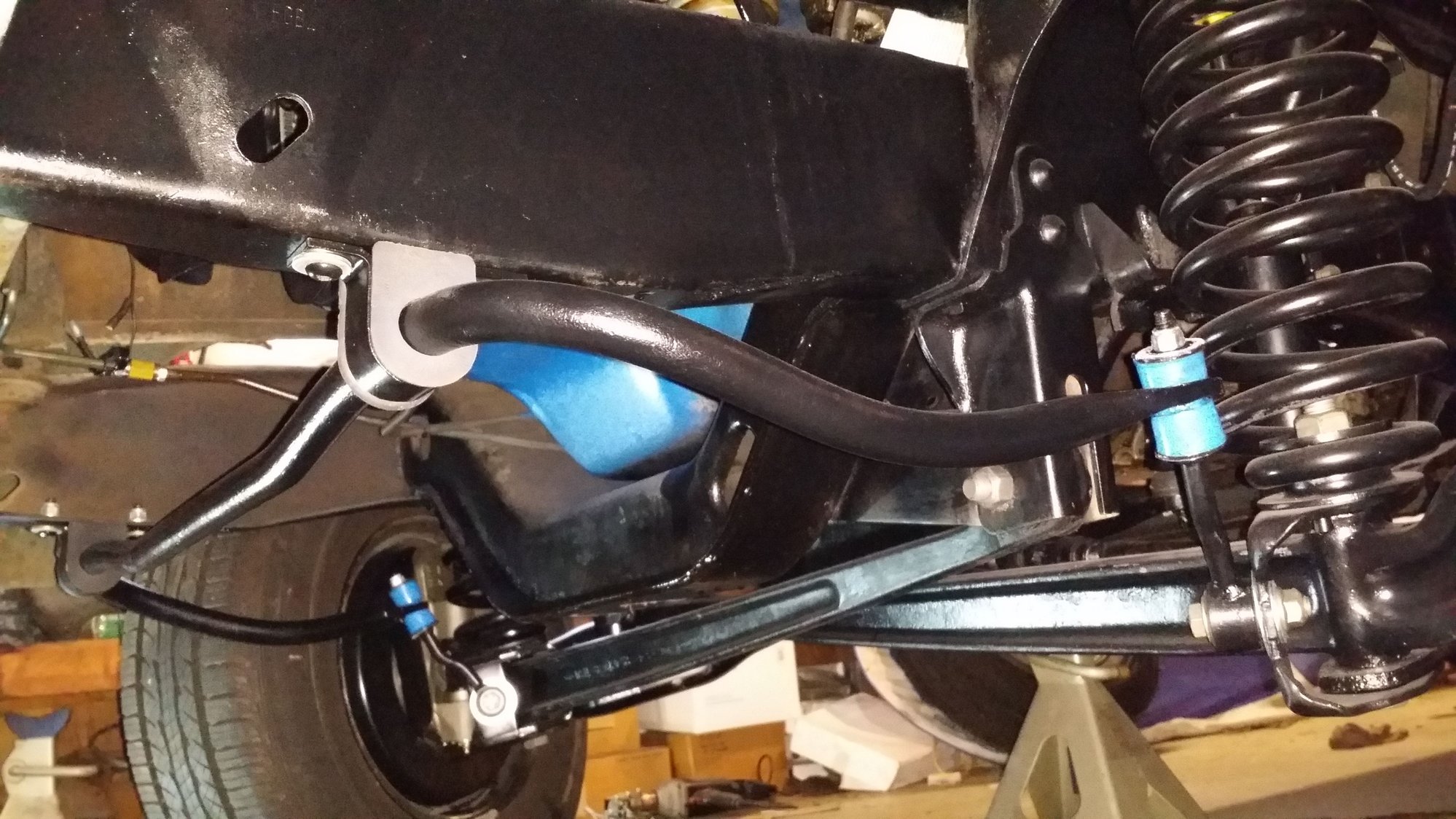

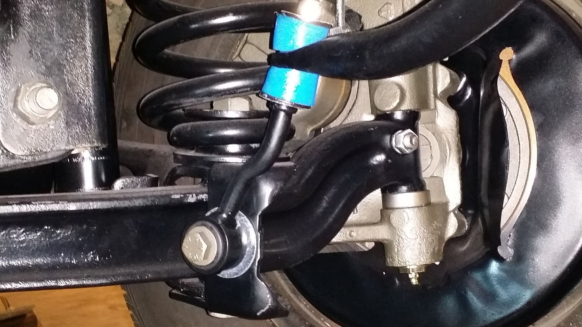

I installed a '77 F100 front disc brake suspension under my '69 F100. I also installed a front swaybar from a '78 F250 Camper Special.
At the time I installed the Dentside disc brake front suspension, I installed new Moog CC808 progressive rate front coil springs. My shocks are new but nothing fancy. They're just Monroe Gas Magnums. They were yellow out of the box. I painted the shocks Ford Semi Gloss Black.
The swaybar and the new springs greatly flattened out my truck's handling when going around curves. It doesn't feel like I'm riding in a boat anymore.

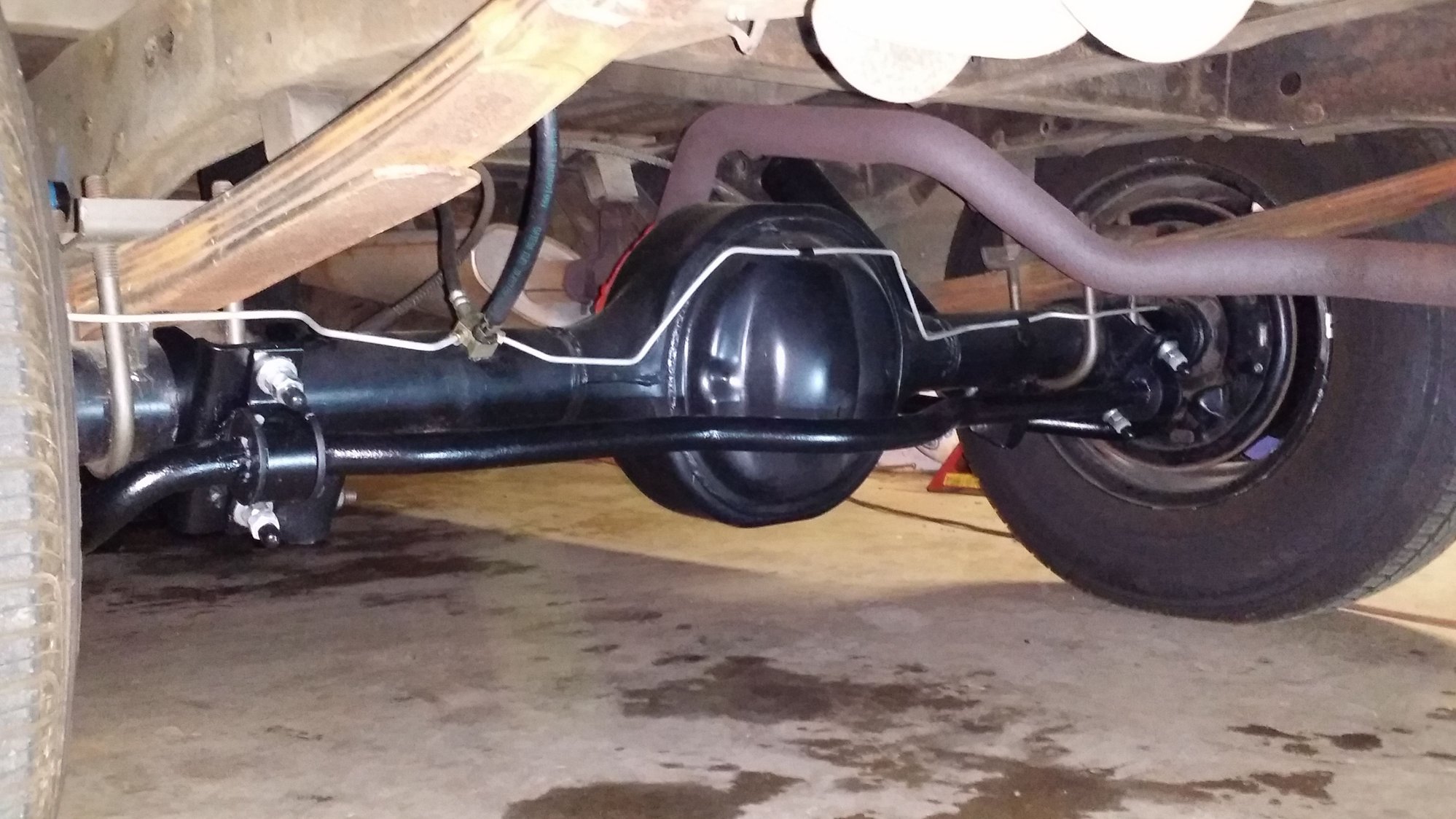

....theoretically, since an F100 through F250 Dentside's rear frame rails are wider (4" overall) than a Bumpside's rear frame width, a Dentside F100/F150/'78-'79 Bronco rear sway bar shouldn't fit a Bumpside but, I did install a rear swaybar on my truck from a '79 Bronco. --I had the front swaybar on the truck before I ever installed the rear swaybar. The front swaybar, by itself, made a big difference in the handling (flatter in the curves) and no longer feeling like the door handles were going to scrape the pavement. The rear swaybar just helped even more.
