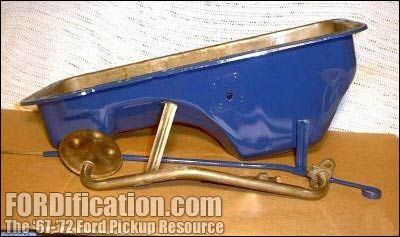

Here's what the rear sump oil pan looks like. The dip stick seems to get in the way of headers for the upper tube stick supporting bracket tab that mounts to an exh. bolt normally.
Some guys leave the stick tube unsupported which causes the dip stick tube to vibrate loose that makes it leak at the pan an egg holes the tube adaptor that is riveted into the side of the pans side. If you see a 4wd truck with one of these pans on it you will see a big gob of RTV all around the area where the tube goes into the pan most of the time with headers.
This the main reason, I've never used one..
