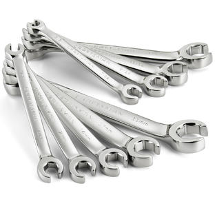

Wow, I forgot about that aspect... yes, absolutely true that specialty wrenches are needed here, I have always used Flare Nut wrenches e.g.

I never had room to swing a wrench down by the steering box.
Maybe my 460 front dress is too wide?
Anyway, being able to reach straight down with a long extension is what worked for me.
They make crowsfoot line wrenches, but the two fittings are close together.
The first one is easy, the second one not so much.

I can't get a Flare Nut Wrench on the fitting. The fitting is 1/2". I can only get an open end wrench on it. I probably am not tightening it enough, but I don't want to round the nut.
