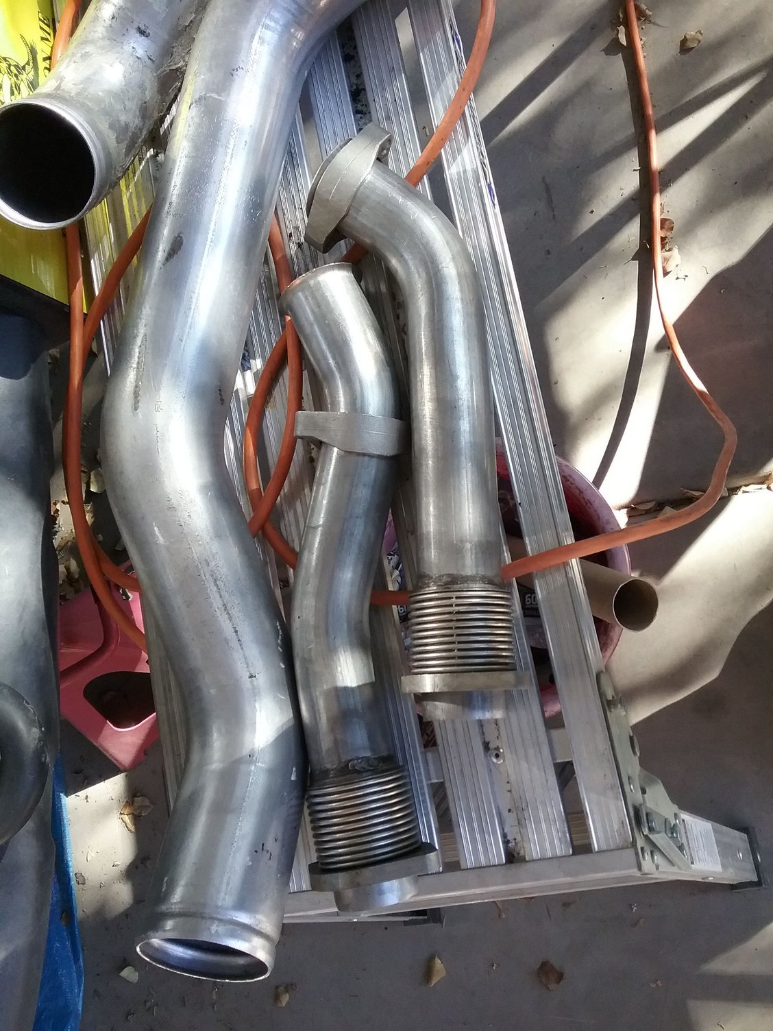

I wouldn't put Dorman anything on any vehicle I own even if it were given to me free of charge. That is just another company that reverse engineers a product (a copy) and manufactures it with inferior materials and cutting corners. There was a time when Dorman was good, but that company was sold a while ago and it went to crap when they started reverse engineering stuff. Ask the guys who installed a Dorman oil cooler, or hpop line.
As for the uppipes, as much of a PITA they are to install, why skimp on that to save but just a few dollars? And then have the real possibility of doing it again real soon. It's like tripping over a $50 to pick up a $5 off the sidewalk.

This has already been posted up several times but here's a good example. I paid for bellows, I want good bellows and welds and tubing.

I can say the Dorman pipes I installed had good welds on them, and I do have a pretty fair amount of welding experience. Enough that I still catch myself referring to TIG as Heliarc . . .

Dormans here as well. I hi temp primed, painted, and heat barrier wrapped them. No issues at all. For what up pipes are, I think any more than the cost of Dormans is unnecessary.
