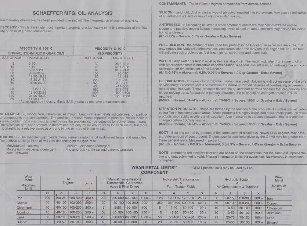

Originally Posted by rufushusky
Here is a good primer on how to read a UOA...
Cheat sheet for newbies reading UOA's | Used Oil Analysis - Diesel | Bob Is The Oil Guy
Personally you can send in a UOA anywhere between 5-6000 miles I think makes the most sense. Anything under 3000 isn't worth it. Just a heads up blackstone is popular but not the only game in town. Polaris, Caterpillar, John Deere, Cummins, Schaeffers... all offer UOAs. They don't give you the little text box but I have seen BS reports that make me wonder what UOA they were looking at when they wrote it up.
x2!!
I prefer UOA reports that show oxidation & nitration values since this show how much life is left in the oil......
here is another good explanation of what some of the values mean......
