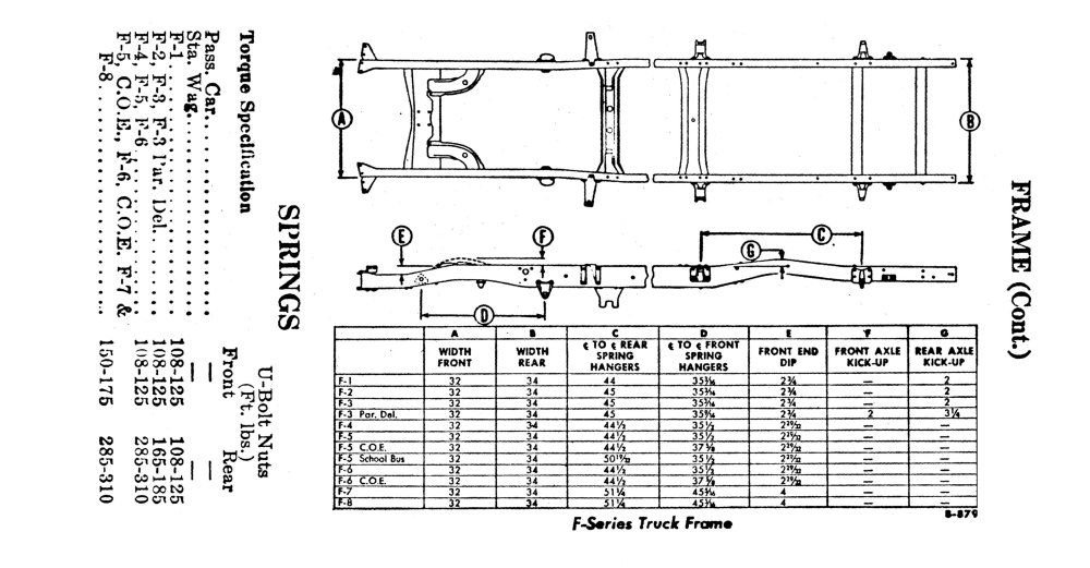

The 53-56 front cab mounts attach on top of the third cross member (where the rear motor mounts attach) from the front.

Here's the earlier F1 frame.

thats awesome! thank you!
