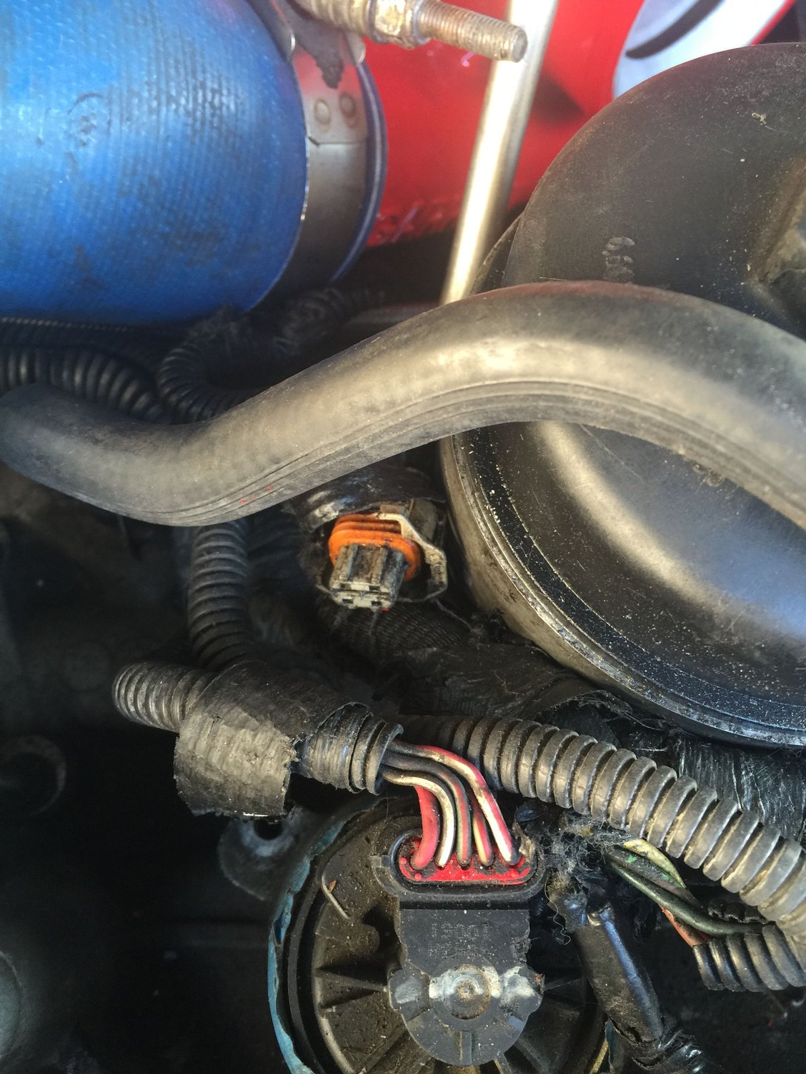

Unplugged Plug?????
2003 f250 6.0.....

Is that a OEM harness?

looks like the plug to the Oil temp sensor that sits right behind the oil feed tube to your turbo...
I agree.
That sensor is a 2 wire sensor.
Also it will need a pigtail put in place of it do to that crack.

Is that a piece of wire attatched to it? I see an aftermarket turbo on there, it looks like the connector to the stock turbo. Maybe the new turbo doesn't need the connector?

If your EOT sensor is unplugged, you should be getting a P0198 code, accompanied by your fan clutch operating at a higher duty cycle (because your PCM thinks the engine is running hot).

FastTimes10 can you have a look at the wires and tell us the color that they are?

You can see it has letters on the case "Garr"
Looks like the oil sensor plug to me as well, just to the left of the EGR.

check your DTC codes. What turbo is that?
