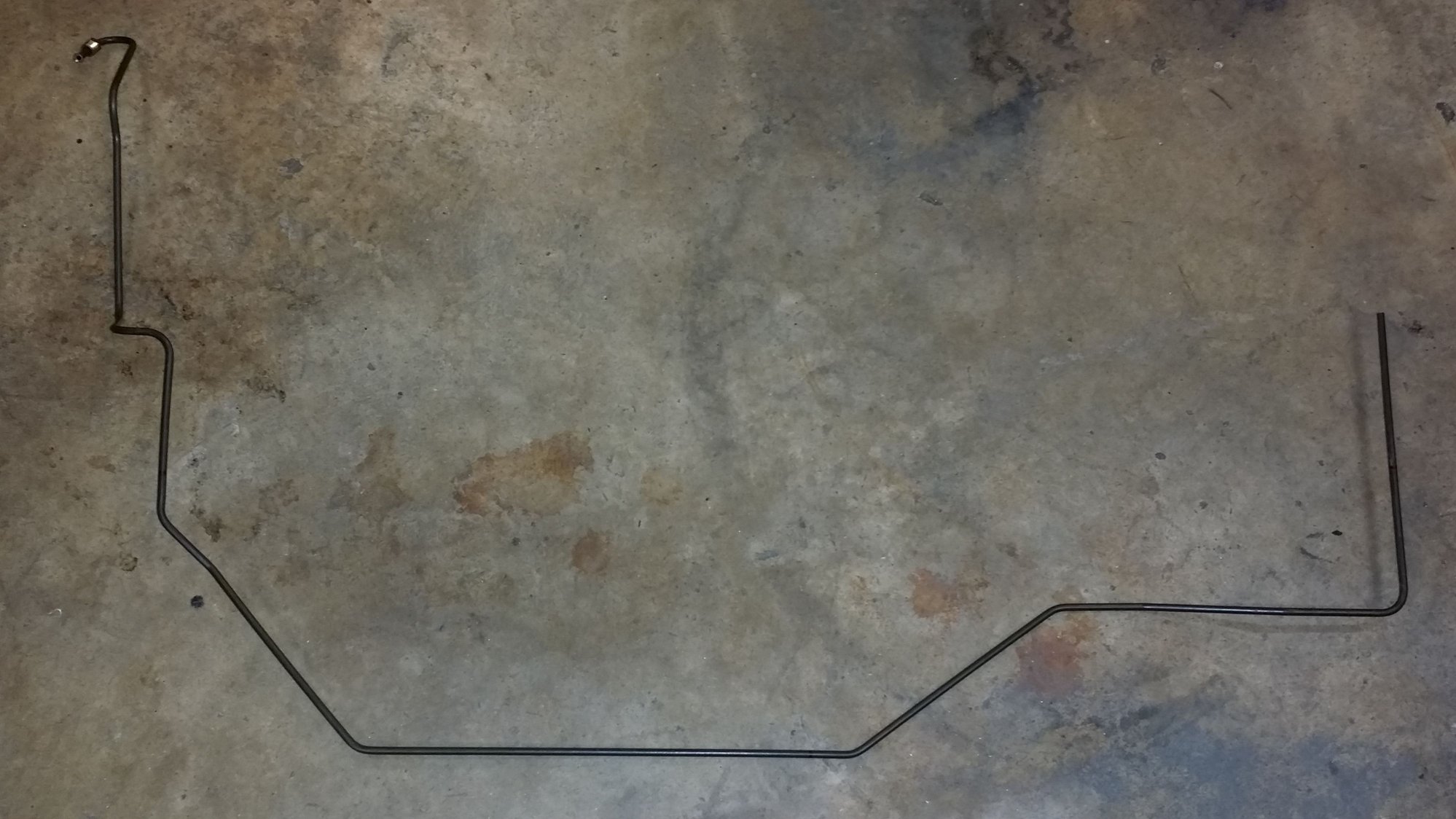

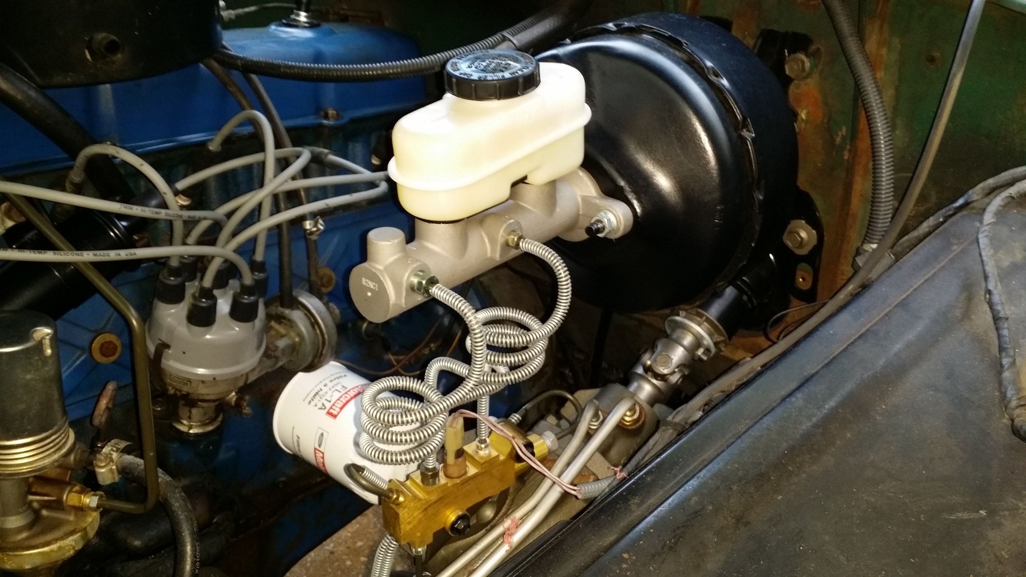

I typically buy 60" straight lengths of 3/16" brake tubing, bend it, cut it to length , put the fitting on and double flare or bubble flare the ends.
These are the lines I made for the installation in my truck --ISO metric bubble flare/fittings at the MC and SAE inverted double flare/fittings at the brake valve.
I started with a 60" stick of 3/16" tubing to make these two lines. I had about 8" of tubing left from the 60" stick after making these two lines.
