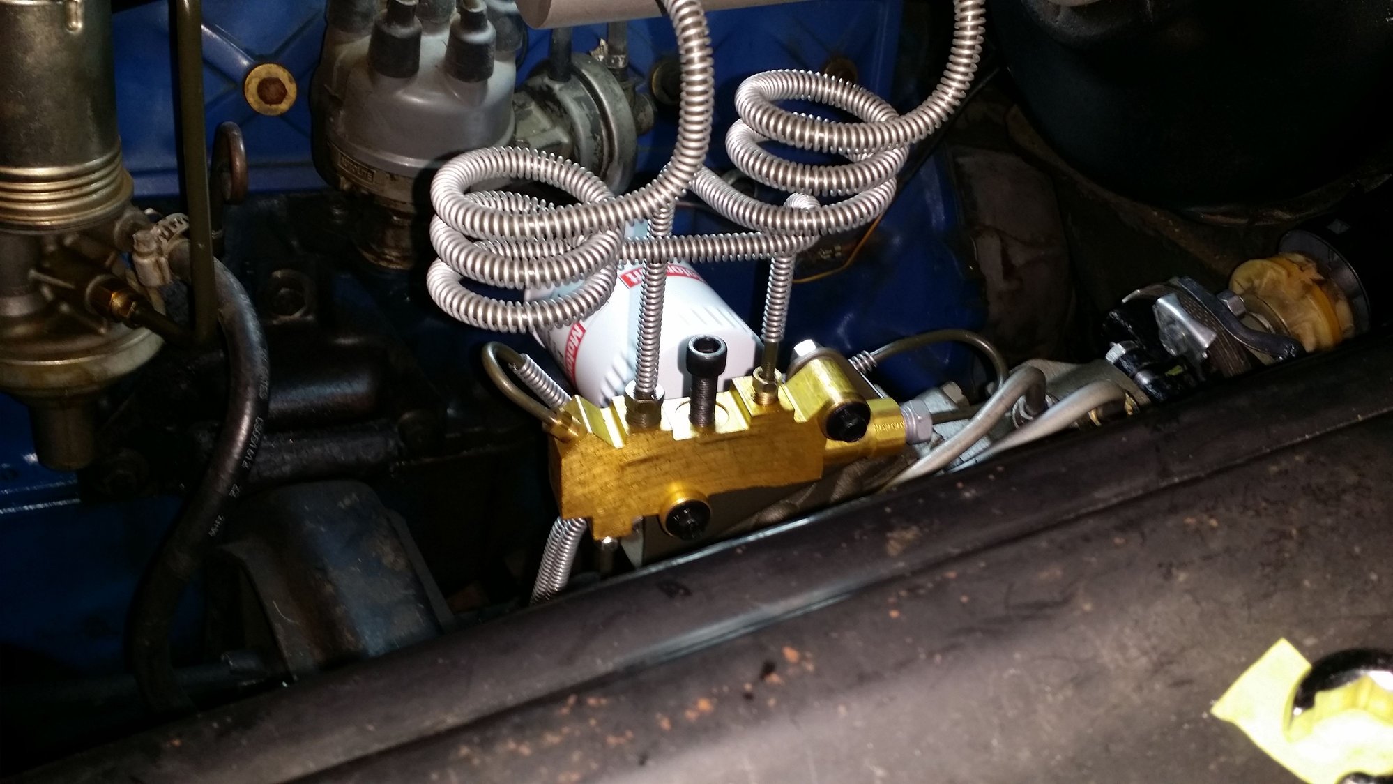

Since you mentioned the forward bowl (secondary side) of the MC had run out of fluid, it just seemed logical that the PDV would have shifted to the secondary side and that you would need to open a bleeder on the primary side to recenter the valve spool.
Since it wasn't mentioned if the brake warning light has or hasn't been lit up since you've owned the truck, it's possible that the valve spool is shifted to the primary side and that you would need to open a bleeder on the secondary side to recenter the valve.
Then again, it could just be gummed up and won't move.

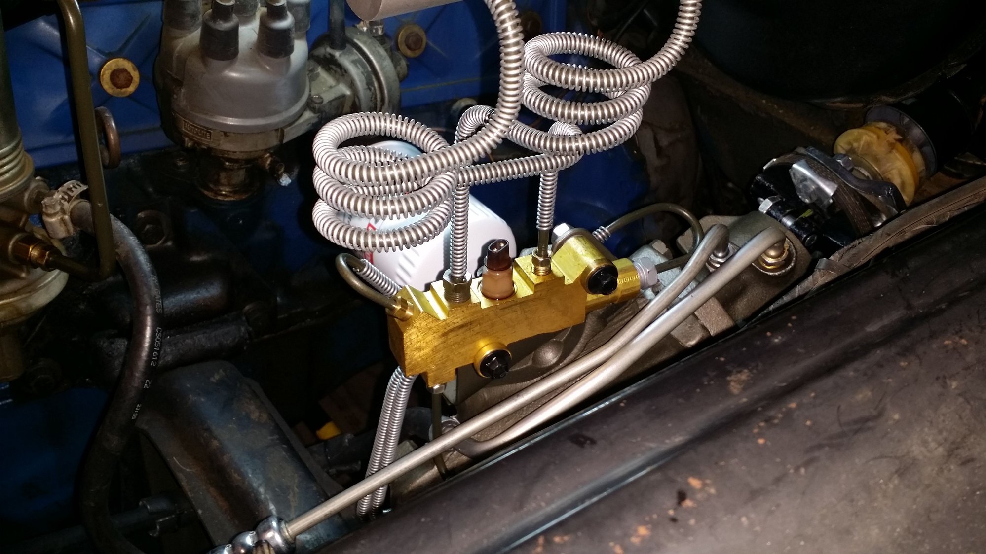

Pulled the PDV apart today and it was stuck in position with the rear brakes blocked. Got that cleaned up and back together. I made that nifty little tool with a piece of flared brake line ,a flare nut, and a piece of i think 8 gauge copper wire. I will put the whole mess back together tomorrow and see what happens after I bleed the brakes. As far as changing the push rod Really??? The stroke and bore of the master cyl are what determines the volume of fluid going to the wheel cylinder. The push rod is designed to give the proper stroke in the proper application. Change it and you compromise the operation of the brakes ,possibly to your great detriment. Just why would any intelligent wrench want to do that??? Why would the manufacturer send something like that without explicit instructions concerning such a thing??? It would open them up to HUGE liabilities. Really??????
