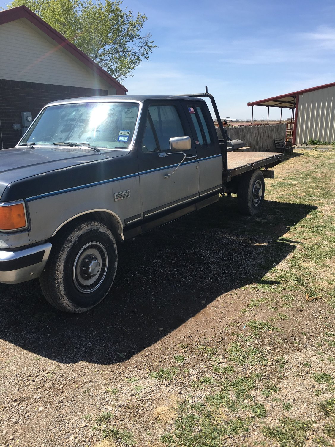

Hi y'all, just wanted to make my first post and introduce my pickup. As of 3/19/16 I am now a ford owner. Used to be die hard Chevy until my dads duramax, but that's another topic. Anyways my trucks a 1988 f250 xlt lariat. 7.3 idi with 145k miles. Motor was rebuilt at 100k due to cavitation, and new injection pump not to long after. Truck is a reconditioned title, but they did good work. Truck was sitting since 2012 and wasn't a daily driver for 5 years before that. I am the third owner and personally know the guy that had it rebuilt. So far I've put a new set of battery's, 2 glow plugs, a fuel return kit updated to late 7.3 style. Still have an issue of long crank time after sitting over night but when starts runs fine. I think I'm losing prime from filter head return line. Fitting is for 3/16 and I've put 1/4 hose on it with hose clamp. Anyways more to come thanks!
