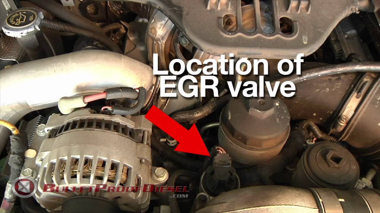

Purchased a 2003 F-350 Super Duty last week. Noticed an electrical connector plug not connected to anything. Any body have any idea what it is for. It is on the passenger side of the oil filter as shown in the photo.
Thanks..........

EGR valve.

As I mentioned....just purchased this truck and I am new to diesel. Been working on gasoline engines for almost 40 years so I am accustomed to busted knuckles and dirty nails. If this plug goes to an EGR valve, where is the valve? I am currently experiencing a no-start situation below 55 degrees and I have to plug the heater in. I suspect the FICM, would this disconnected plug cause problems. The truck idles smooth and runs great after started.

The egr has probably been deleted. You can get cheap aftermarket filters that come with cheap caps as well. Buy the proper ford stuff as quality is much better. I am guessing that's a 6.0L you have?

I found a delete plate today labeled "Sinister"....the EGR valve was eliminated. I am learning what an important role oil plays in a diesel.....and yes mine is a 6.0. Did check the FICM output voltage today. It was 47.9 at key on and 22.7 while running. Will be sending it in for a rebuild. Checked the prices for an OEM Motorcraft oil filter & cap today.....not cheap. Thanks for everyone's help.....much appreciated.
