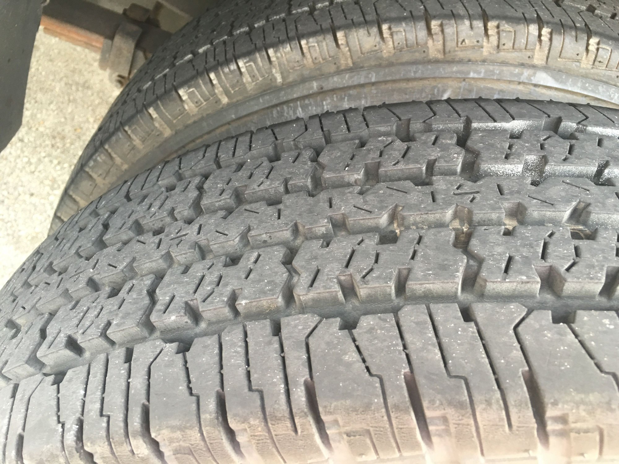

I just had the same problem with my 2011 f250. I left it for my wife to drive while I was out of town. I knew the tires had to be replaced as they were getting bad but was hoping to get some in the next couple weeks. Well she called me and said the truck would shake really bad at 60. When I got home I drove the truck and it was pretty bad. I got up to 65 and one point and didn't realize it cause it wasn't shaking then all of a sudden it started to shake and about ripped the steering wheel out of my hands. I took it up to my mechanic cause I thought it was a track bar issue. He called me an hour later and said it was a bad tire and the belt broke. I know you said you had them balanced but it could be that

One of the biggest mistakes you can make is to think that a newer part (like your tires) are not the culprit because they are not that old. AT this point, suspect everything unless you have proven it good.

Originally Posted by CampSpringsJohn
There is something majorly wrong here. What brand of tire is on your truck? How old?
Firestone transforce ht 235/85/16
They seem to be in good shape still .
Ford dealer told me the tires I have on are crap. And that I should change them .

The rotors are not the problem. They can shake the brake pedal, when you're using it.
Tires are very heavy compared to the rotor. When they shake, it gets your attention.

They may not be great tires, however if you've had them balanced and the shop performing the work didn't mention any issues with the tires; it is unlikely that the tires are an issue, even if they are a little heavy on the balance weights.
Judging by your posted videos, you have a drivetrain or suspension issue.
