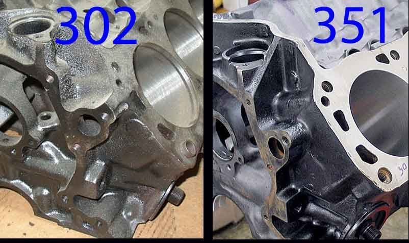

Hard to tell with the air cleaner assembly on it if it's a 302 or a 351W. If the width of the intake (between the heads) is around 9", it's a 302. If the intake width is 10-3/4", it's a 351W.
Another visual identifier. The hole for the distributor will be very close to the rail where the forward seal for the intake goes. The distibutor hole for a 351W will be much lower, in relation to this rail.

Thanks Ultra...
I'm on a teensy phone with few reference files.
... and plainly visible is the vertical casting rib on the 351W.

Evidently, we were writing at the same time. You just hit the post button before I did. I had forgotten about the rib but remembered the distributor hole being right at the top of the block on a 302.

Ok, distributor hole is the lower one, so must be the 351W. Is there something special about the 351W? Or was this likely more of a "well, sorry you blew your motor... I don't have another 302 in stock, but I do have a 351W available -- want me to put that in for you instead?" Question 2: So when I go to auto parts store to get a new fuel pump, and they say, "351W in your 71? I don't see that in my list of options..." Is there a different car/truck that this engine was common in, so they can find out what fuel pump (or other part) I need? Thanks again - I really appreciate it.

The 351W wasn't stock to a Bumpside. They weren't installed until the Bullnose trucks came along ('80-'86 body style). It was also used in cars --the first use in a Mustang was 1969.
The 351W will give you an immediate 49 cubic inch advantage over the 302 so, that's a plus. The block casting numbers and date will be located at the right, rear side of the block. You would have to remove the starter to see them.
