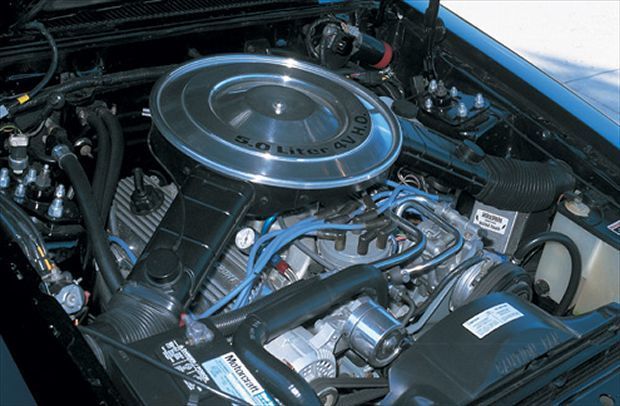

This is a photo example of an early '80s Mustang (dual snorkel) air cleaner. In 1981, my best friend bought a 1978 Ford Futura, in stone stock condition, from the original owner. The factory (single snorkle) '78 aluminum air cleaner lid had the nomenclature of, "5.0 Liter" written on it in this exact same font type --without the "4V H.O." designation on it.

Originally Posted by ultraranger
This is a photo example of an early '80s Mustang (dual snorkel) air cleaner. In 1981, my best friend bought a 1978 Ford Futura, in stone stock condition, from the original owner. The factory (single snorkle) '78 aluminum air cleaner lid had the nomenclature of, "5.0 Litre" written on it in this exact same font type --without the "4V H.O." designation on it.
Exactly, here it is in print:
http://fzbooks.150m.com/78FuturaBrochure06.html
Originally Posted by RichS2659
Actually ND, 351M/400's got theirs in 77 as that was what my 77 F-150 had.
How dare you question NUmbersDummy!
See, contrary to what the Master Parts Catalog says, hell does freeze over.
MPC's can say all they want. I know that they don't always tell the FULL story and I know, unequivocally, that my friend's 1978 Futura had the words, "5.0 Liter" written on the factory air cleaner lid. 1978 was definitely before the 1980s.
A MPC is not always the gospel of what was or what is.
