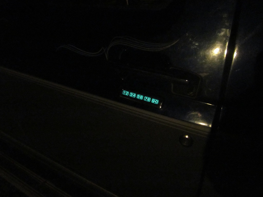

They have you covered here. That stick on keypad is for a newer generation of modules.
If you want a keypad bad enough it can be done by cutting a hole in your door, getting a keypad from a salvage yard, and running wires to the module. Not too bad. I did it and the parts cost me less than the stick on keypad (as long as you feel your spare time is worthless.)
In fact I posted some pictures of my install in that forum that was referenced above.
