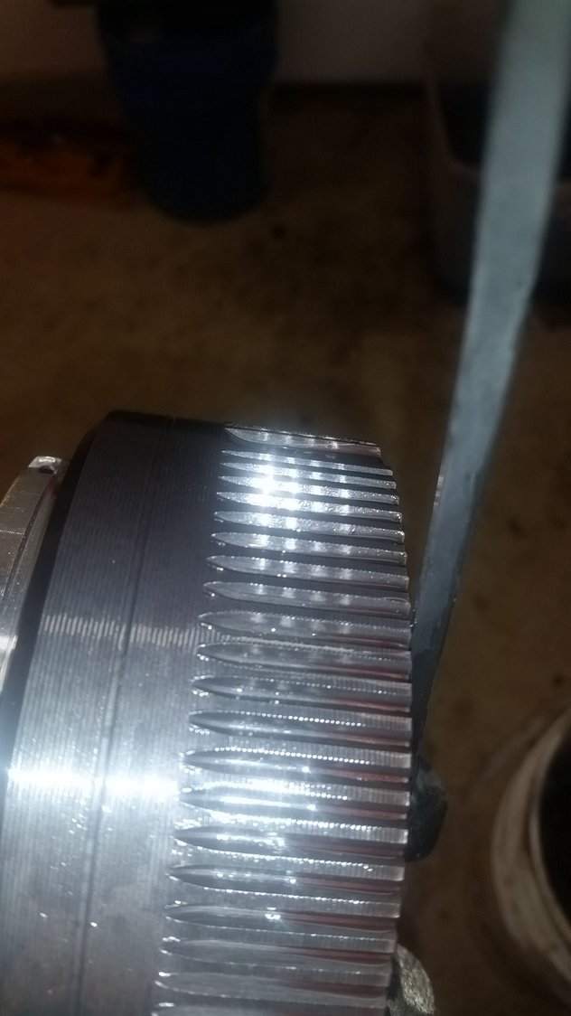

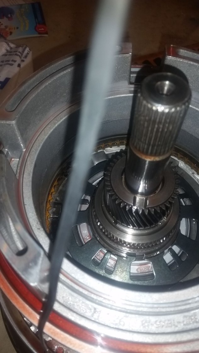

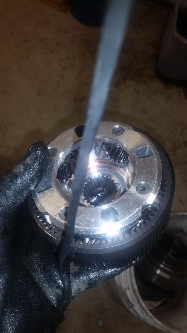

Mark please help me I'm begging you what could cause an e40d that looks super clean and never abused lose all gears I've got the trans out and checked as far back as the front planetary it looks like it was rebuildt yesterday it looks too clean minimal wear plz help me input shaft and planetary are good

You need to take it all the way down. I've seen sun gear welds break from the shell they are attached to. You need to look close to see this. If you only checked the front planetary you need to remove the rest and check that, too.

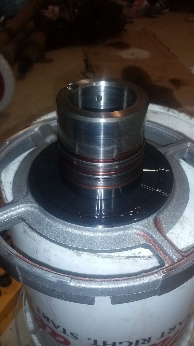

Ok mark so I got it all out and sungears planetarys and clutches look brand new not burned or anything nice light brown clutches still have plenty of material left only thing left on casing Is reverse clutches as I have to take off overdrive housing and remove bolts to check the clutches for reverse any ideas?
When it didn't move did you try the 1 and 2 position? If it moved there the problem is a failed (or installed backwards) overdrive one way clutch.
