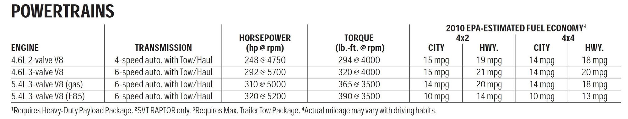

politics completely aside:
you do indeed gain horsepower and torque by using e85. i'll offer a snip-it from the 2010 F150 brochure:
the 25lb-ft is very noticeable when using the fuel too. most of the bump comes in just off idle and at very low throttle angles. it is enough of a bump in the torque curve that the transmission has to recalibrate the shift strategy. the thought process used above simply doesn't apply to the vehicles currently being made. most of them advance the timing as far as possible while staying out of knock and do so on a continual basis to optimize fuel economy. so there are some gains to be had just by using premium, but it won't be very noticeable. e85 on the other hand allows for a very aggressive timing curve, which is why you get such a power increase by using it.
also, your fuel mileage tanks in the winter, but not because of the ethanol. they use a different formulation to increase volatility to aid in cold starting. this holds true regardless of how much ethanol is in the fuel. the fuel companies like making winter gas because it is cheaper, but the EPA only allows it within a set time period because of emissions. there is a ton of info out there on the topic, but here's the first good one that google found:
http://newsroom.aaa.com/2013/06/what...lend-gasoline/
The real benefit to using ethanol in the winter is because it will absorb moisture in the fuel system caused by condensation.
as for switching back and forth, yes they say not to alternate often, but I've done it quite a bit without any ill effects, other than the odd shifting behavior when you first switch.
the mileage doesn't seem to drop off quite as badly as the snip-it above shows either. in general use on the project I usually get 13.5ish mpg with e85 and 16.5ish mpg with e10. I don't think I've ever used pure gas, so i'll let that go unspoken for. on an long interstate run, I've gotten pretty close to the 18mpg it is rated for with e10, but I've also gotten 15.5mpg on e85 on the same trip (different day).
the best compromise for me has been e30. the mileage is within about 1mpg of what you get with e10, but the power is noticeably better, much like you get with the e85.
there's just so much myth about ethanol that gets repeated over and over again, it simply astounds me.

I understand where you are coming from, but what you are supporting is exactly what I said. It's not the fuel producing more power, it is the higher octane of the fuel allowing the engineers to design higher horsepower engines. That is the point I'm trying to make.
My truck is Flex Fuel capable. It only has one horsepower and torque rating. If my horsepower and torque were to change depending on whether I was burning gasoline or E85 fuel, there would have to be two horsepower/torque ratings. And what if I decided to start burning LPG? Does my horsepower and torque rating change yet again?
Many people mistakenly believe that higher octane fuel will deliver more horsepower and the gas companies encourage this thinking so that folks will buy the more expensive gas at the pump. They say you'll get better performance and more horsepower using their top-of-the-line (and incidentally most expensive) high octane gas. But if you read the fine print, their claims center around a cleaner running engine; supposedly because the more expensive gas has better cleaning additives, etc.
I simply want folks to realize that higher octane does not higher horsepower make. It allows higher horsepower, higher compression engines to run without detonation. That's it.

Thats not exactly true though. It's the same engine and nothing changes (mechanically) except the fuel
The higher octane fuel allows the same engine to produce more power by way of more ignition timing. And more ignition timing means more power.
These engines are optimized for 87 octane, and marginal for e85, yet despite of that they make more power on e85. Running e85 at 10:1 compression os akin to running gas at 6:1. If they would optimize for e85 the power spread would grow and the economy spread would shrink, but with e85 not being everywhere they simply can't do that.
Even though it isn't being advertised, I'm sure you flex fuel car makes more power on e85, and would make less on LPG. It's all in the way the pcm handles the different fuels. If it advances the timing, there's a good chance you are going to make more power and lose less mpg. If it doesn't then power wont go up and economy will really tank.
