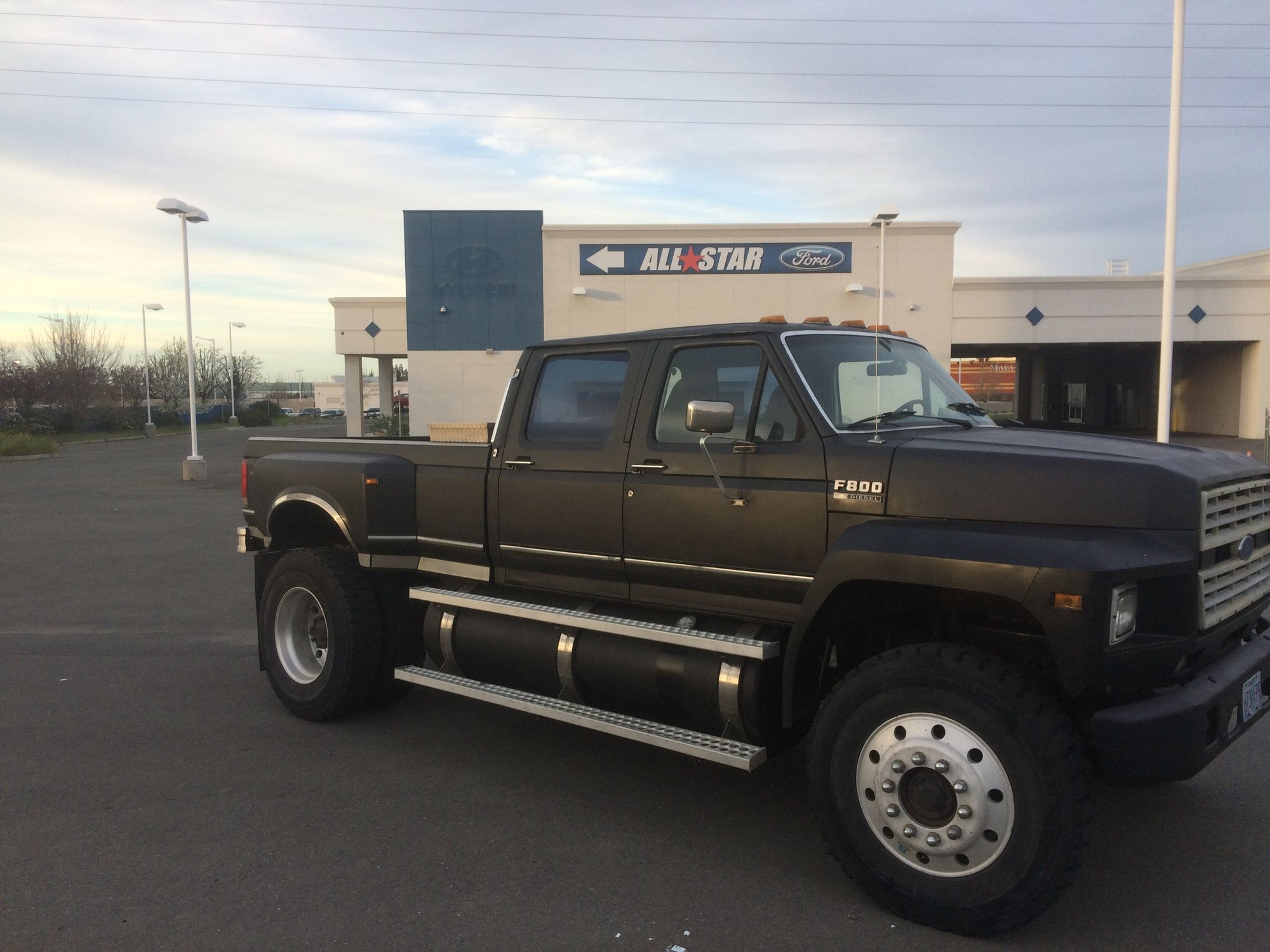

Hi, I got a Eaton axel in my 87 f800. The only tags on the center section say; a43200r1500, avc87002134, 456. So what axel ratio do I have, 456? Thanks

It's a single speed axel and the doors are off a 96 and the cab I'd is different from what I've got. I'm starting to think she's a hodgepodge of truck parts. I'd like to put a taller gear in her do you know what model number it is?
I did a Google search and I don't have much experience with this large truck stuff so I like to ask for other opinions. Thanks for your time

Thanks for the help but at about 2800 rpm she runs down the highway at about 60. I'm trying to run at 75 at that rpm. I have thought about an overdrive but I don't know where to start. I was told she has Allison tranny and I don't know if it's divorced set up or what. Any input helps. I have the service manual that showed up yesterday. So what do I need to know about big overdrives? I have a waren unit in my ****** and a Mitchell in my model a.
