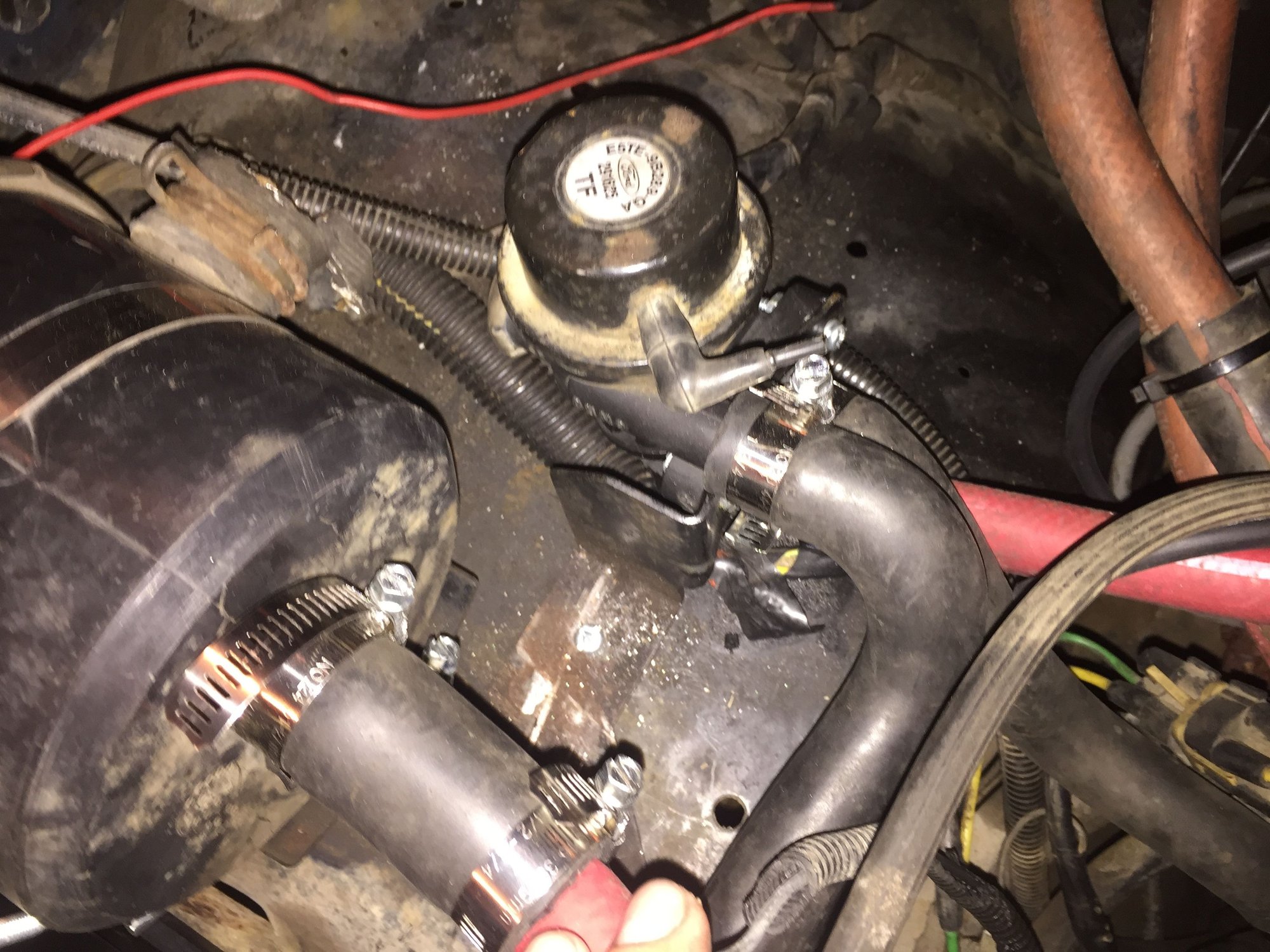

Hello all I have a 1986 Ford F-250 351w. Now my problem is I cannot find where the pcv valve is connected. I have heard it connects to the valve cover but since I bought the truck I have had a regulator for the smog pump system attached there. Here are some pictures
Help would be much appreciated thanks a lot!
The regulator is hooked up right now. Should the pcv valve go there and the reg. go somewhere else?

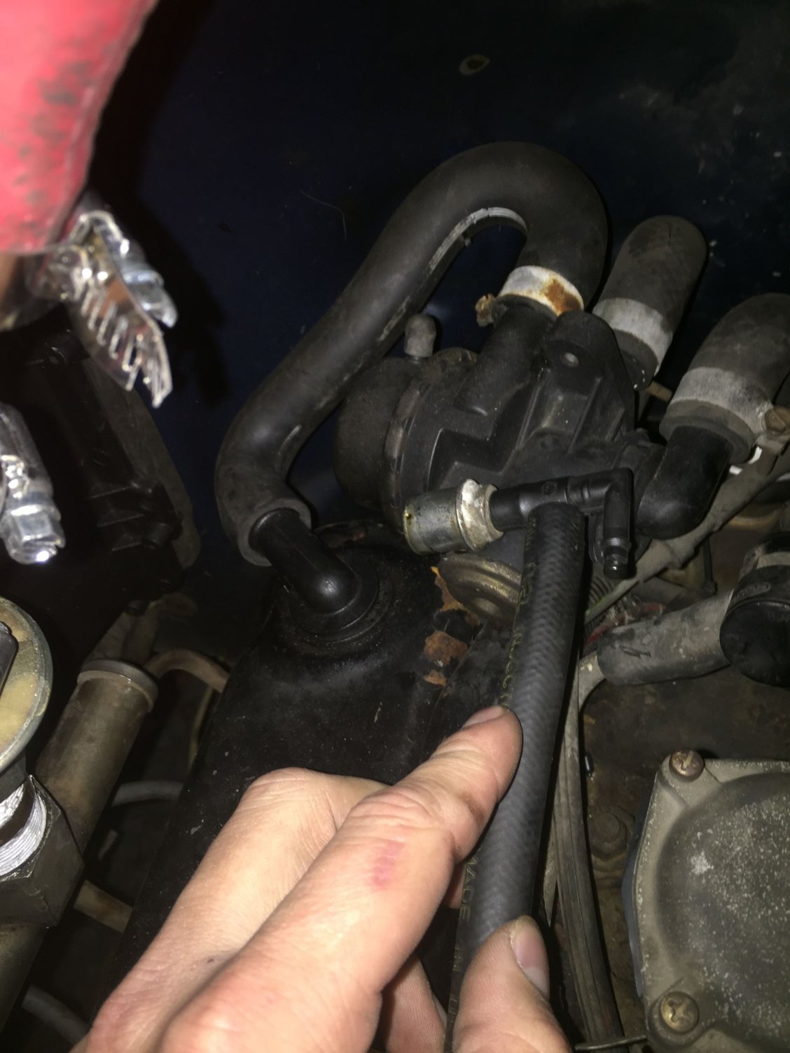

Yes, the PCV valve goes into the valve cover (I'm assuming the other end of that hose leads to a big port under the carburetor), its job is to suck out the blowby gasses back into the combustion chambers.
That device you're calling a regulator looks like the Air Bypass Valve (BPV on your sticker on the radiator support) whose job is to release air to the atmosphere (instead of into the exhaust) during certain conditions, e.g. on deceleration (to prevent backfires).
Somebody has done a hack job there, presumably in an attempt to "disconnect all that smog crap" and "make it run better."
Sheesh, I just have to shake my head and wonder what they were thinking.... clearly an idiot, he is... put the PCV valve in there, don't worry about the AIR pump hose for right now.

Kinda counterproductive blowing air *into* the valve cover...
The bpv discharge should go to a fitting on the side of the aircleaner.

Now would you by chance know where that broken red vacuum line leads to? I believe it is attached to the egr
I cannot find a fitting on the side of the air cleaner

Red is 'manifold' vacuum.
The egr should have a green line.
Is there a vacuum routing diagram on the radiator support?
Are you sure that you have the correct air cleaner housing on your truck?

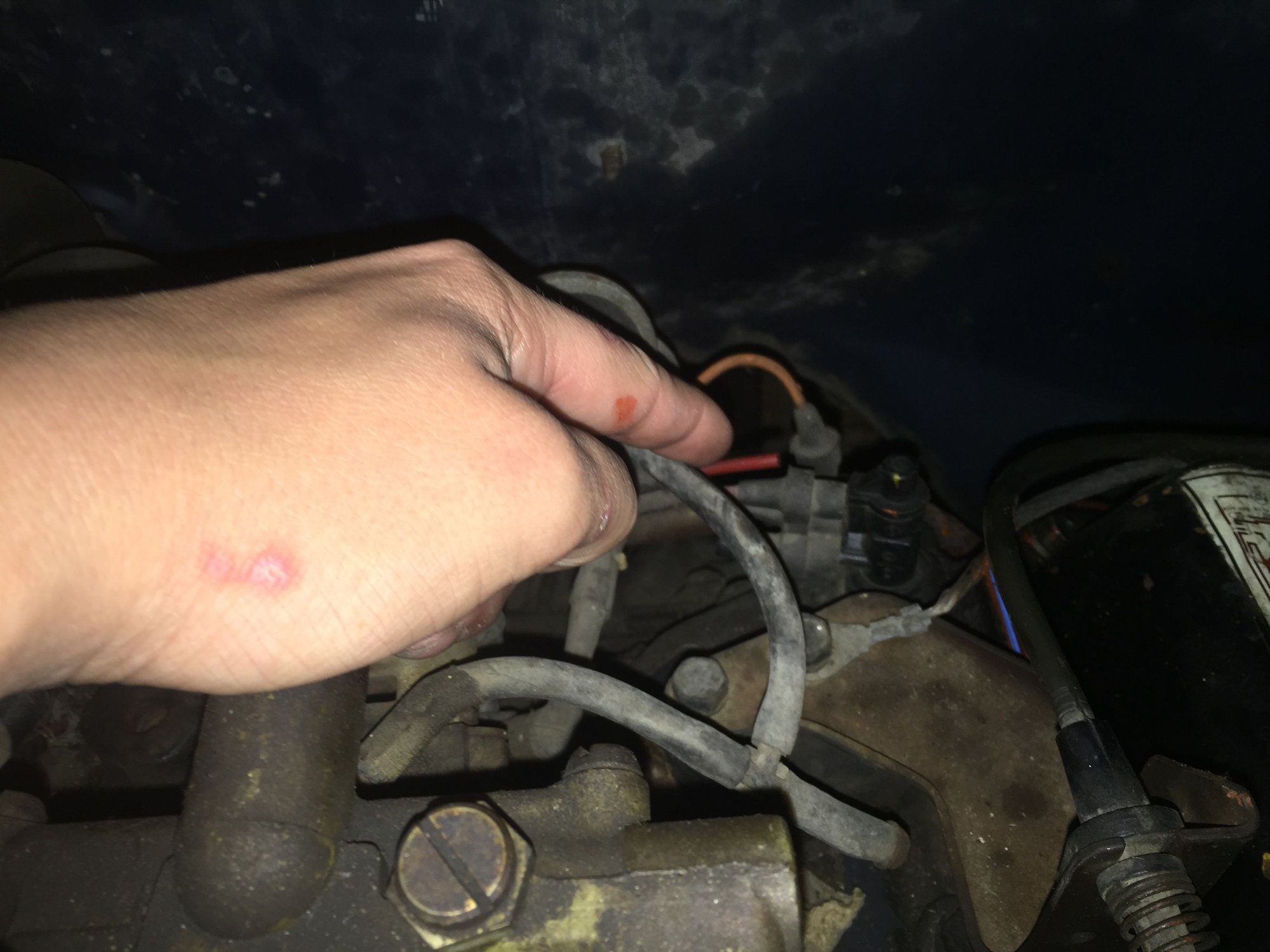

I also cannot find where these lines lead too

Here is the vacuum diagram with engine bay pics and the lines that I need help finding

It appears your bpv vents directly to the engine compartment.
Connecting the pcv to the valve cover should help with oil control.

Follow the green egr line from the thermal vacuum valve on/at the thermostat housing.
