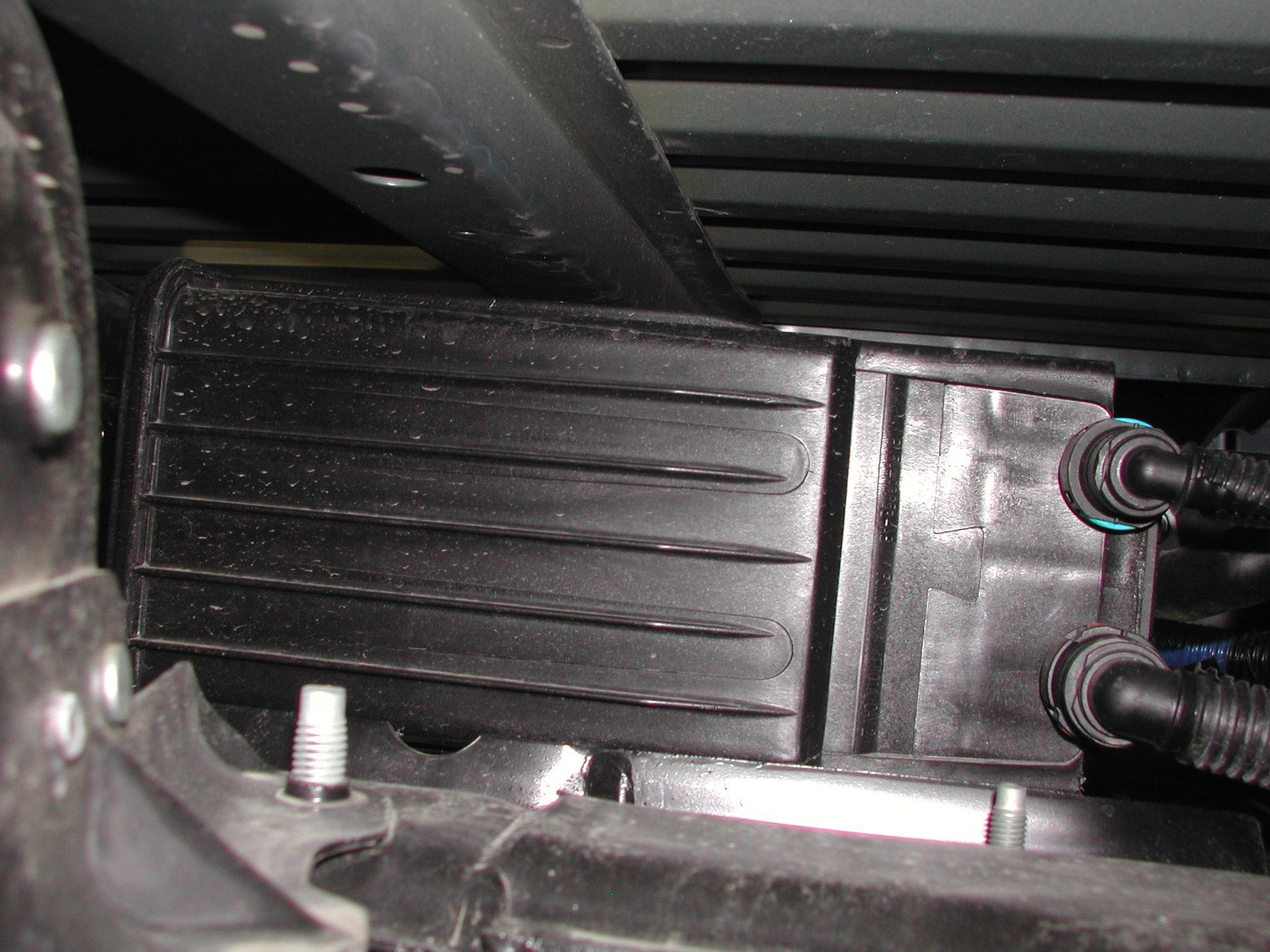

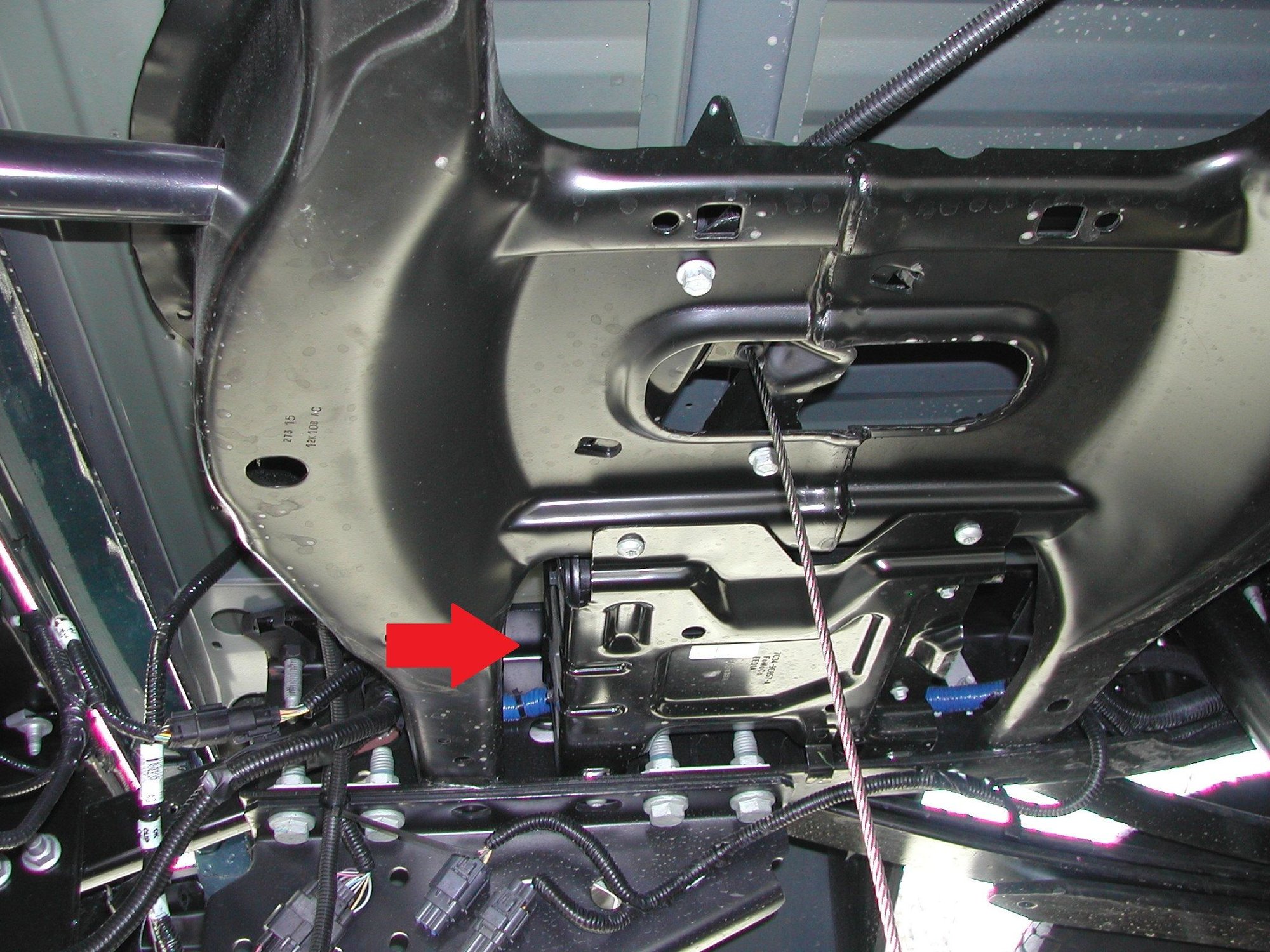

The box is about 6-8 inches square and about 2 1/2" inches high. I'm editing my description because my eyes (and apparently my memory) are not as good as they used to be. It's really hard to see but the box is black. appears to be sealed and has wiring harnesses attached. Here are a couple of pics. It's hard to get a shot because of the location.
Location above spare
Now I'm really curious!

Is your truck gasoline?
Ford has been putting evap/emission parts back there in other trucks.
Yes, mine has the gas engine.

Looks EVAP-related to me with those hoses going into it.

Again, I'm 99% Sure that's the FPD Module.
