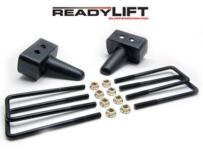

I wasn't focusing on the blocks when I took this pic, but you can see the right one in the far right of the photo.
The "wings" maintain bump stop functionality in the event of bottoming out the back-end...

I was wondering what those "wings" were for, and now it all makes sense. It looks like you used the factory blocks and the aftermarket 3" blocks. is that what I am seeing or are the "3"" blocks really 1 3/4" to make a combined total of 3"?
No, I didn't use the original by stacking; I took the Ford 1-1/2" spacers out and swapped in the aftermarkets, so the net lift was about 1-1/2" over stock using the aftermarket 3" tall block.
What you see underneath the new block is the axle mounting pad that's welded to the axle tube itself.
