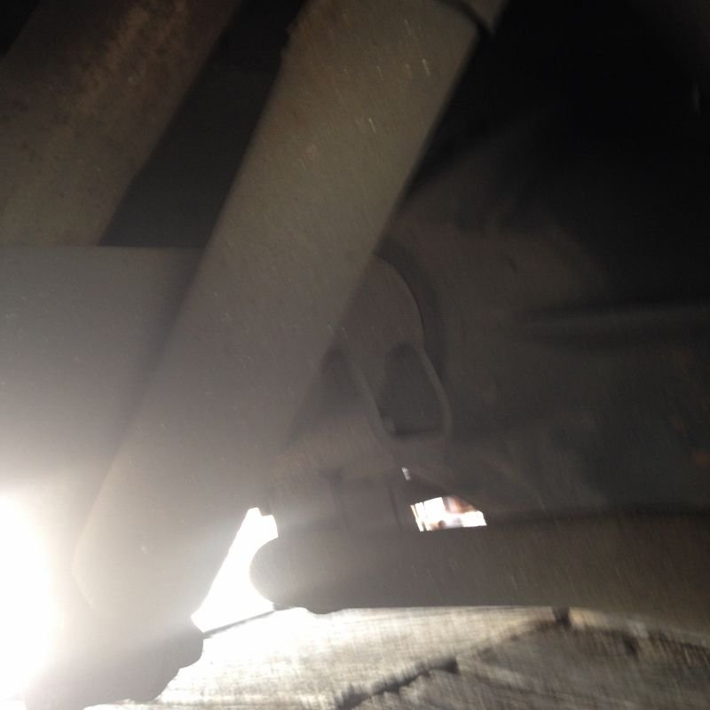

Here's what the rear sway bar on that E-450 short bus looks l like. I'm guessing it's 30mm. My 1 1/8 open end was a perfect fit and an inch is about 26mm. The axle mounts are welded and the end links mount to the frame up near the front spring mounts.
They're not the best but I think you can make it out.

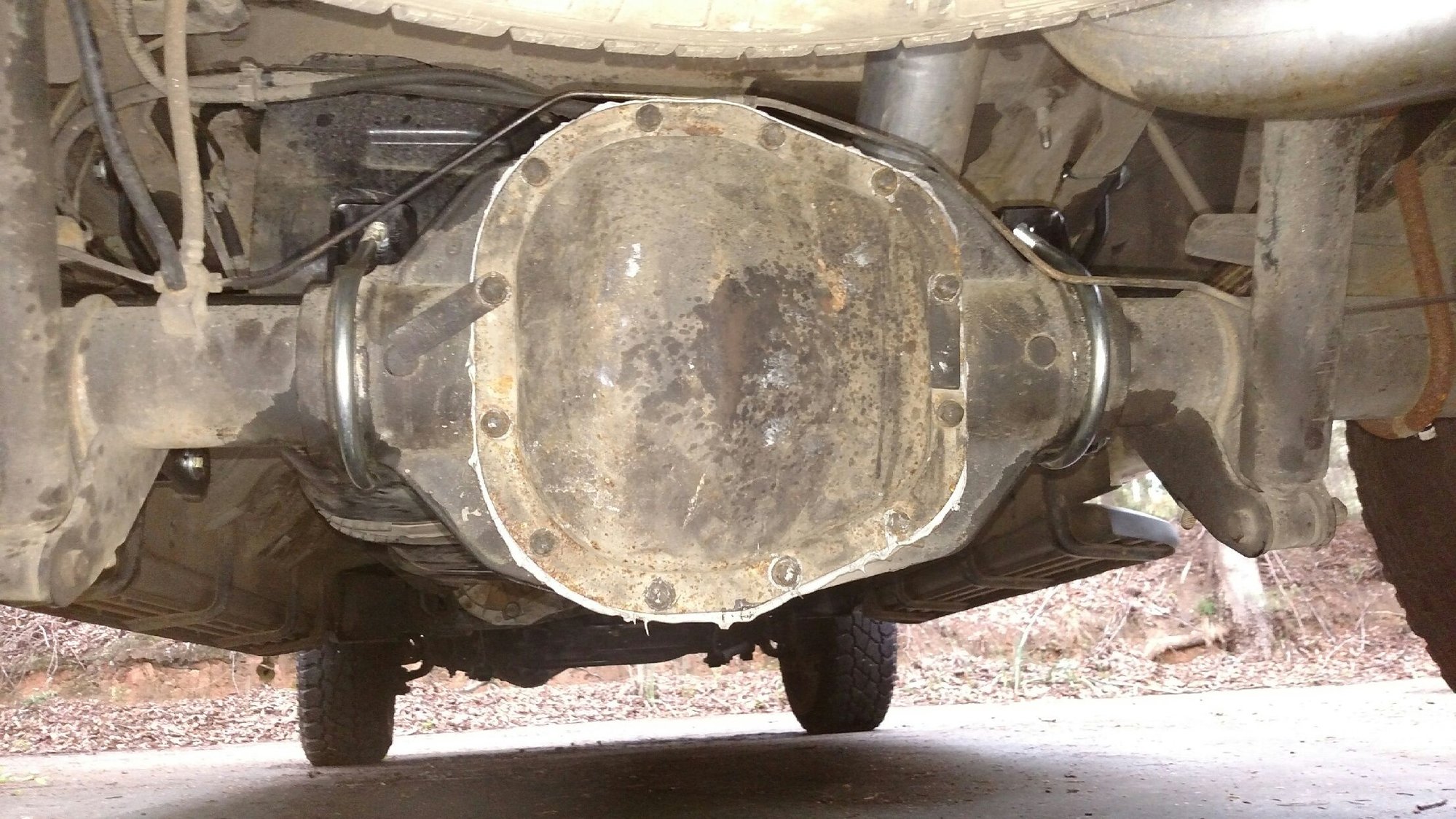

The Hellwig sway bar arrived last week and I finally had a chance to install it. No test drive yet though, so the anticipation will just have to build a bit longer for that review. Below are some pictures comparing the stock 2000 F-250 bar to the Hellwig 7268 bar.
OEM sway bar... not very intimidating is it...
Hellwig 7268 side by side with OEM
Hellwig mounted driver side
This is my only area of concern which is at the top of the differential. I can lengthen the end links to get the bar further from the guards of this sensor, but I also wanted the bar as level as possible to the frame of the truck. I will keep an eye on it because it might be just fine the way it is and if not, I will make adjustments to the bottom of the end links.
Picture from the back. Never mind all of the oil residue. I sprayed all of the bolts down with ATF/acetone a couple of days ago.
