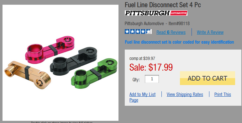

OK, I am just a couple of steps away from getting the engine out.
1) Having trouble with cooling fan removal. I suspect that my Craftsman wrench is not strong enough and the jaws are spreading and coming off the bolts. I did get one loose with a chisel but the others are a no go. Any tricks on this would be great. I am able to hold it still with a helper and a crow bar under the pulley. I don't have the tool for holding it still and I'm hoping to get away without one.
2) How do the fuel hoses come off of the tubing at the bottom of the engine? I snipped the clips off but the hoses don't seem to want to come off of the tubing. I would prefer to save the tubing and hoses if I can but if I have to I'll just cut the tubing.

Tips.
1. Tap wrench with end of hammer. Looking for sharp strike to break bolts free.
2. You snipped the clips AND pulled the 2 legs out of the connector, right? It's a U-shaped clip, be sure to get it off. You may also have a holder of sorts on the outside. Which did you clip?
3. Channel locks to grab the hose over the hard line and give it a little twist to break it loose from the metal, then have to pull it pretty good.

Page 3 post 37 is a little detail on how I got mine off. For me it didn't turn out well and ended up breaking the line. If I remember right 1/2" was for the supply line and 3/8" was for the return. Unfortunately, you broke those clips.

Ahhh...those are different clips than I referenced, sorry
Those metal clips do pivot out of the way like Scotty shows, then you use a tool like this to insert into the end and push to release and remove the line.
