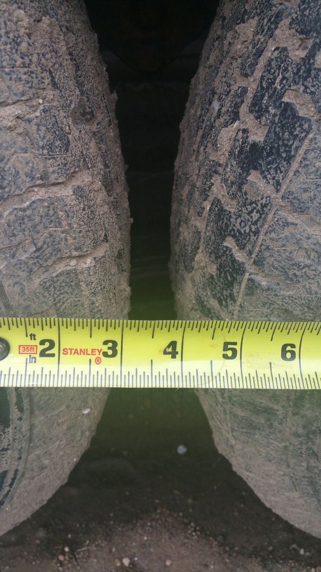

This is how close the tires are. A friend has a tire shop and says we will try a LT235X85X16 10 ply tire. Going to wait until after planting season to get them. Thanks for your help guys.
Use the Tire Rack website. Choose a tire then look under 'Specs' and it will tell you the overall diameter .... Tire Rack - Your performance experts for tires and wheels

We did use the site. The LT tires are 1.2 inches in diameter larger. So using math it will be around 1/4 inch closer per tire. So I will,have around 1/2 inch clearance. Really close. Wonder about heat from tires.

my spacing is more like 4 inches between.
I still think you can go up some.

We are looking at LT235X85X16 10 ply. Wider but that should help and it's only $40 more per tire. Won't do anything until after planting season.

I think you are looking at a diameter of about 31.7

If I remember correctly the st tires are 30.2

not much of a difference.

No there isn't but I only have less than 1 inch to play with so have to be very cautious. Seems like I read somewhere about distance between tires (in line) for cooling.
