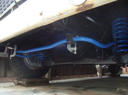

I'm running Bilsteins in front and Monroe Gas Magnums in back. The ride quality is 4.0.... a front 75-79 Dentside swaybar also allows a more spirited driving experience.
Mocked in place....
