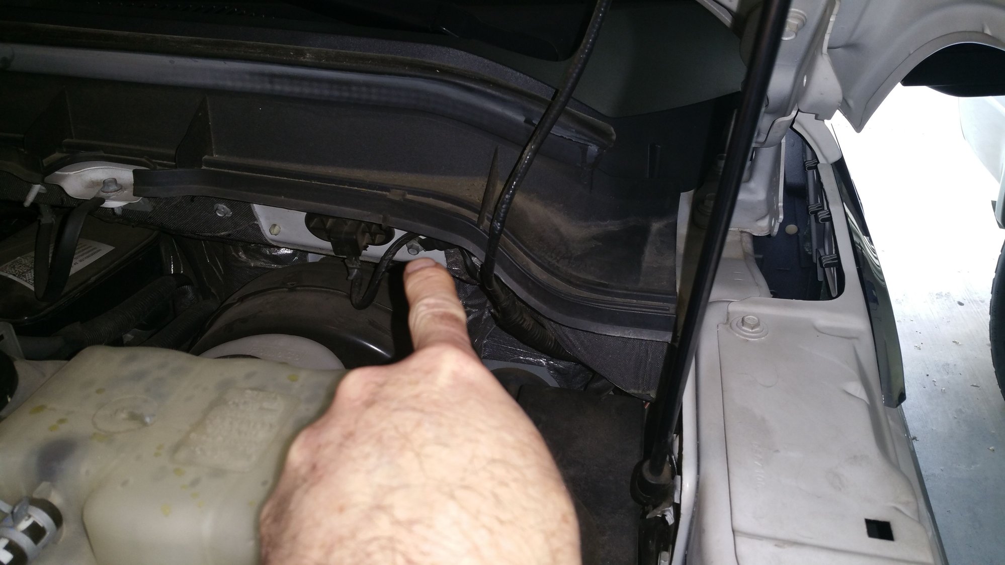

There is a screw on the engine bay firewall on the drivers side above the fuse box and over to the side a little, this screw attaches a bundle of ground wires to the firewall. I loosened this screw to add a ground wire for a light bar and the error code you had came up. I tightened the screw down with the ground wires and the code went away. So try tightening that screw and clear the code then start it a few times and see what happens, hopefully just a loose ground connection.

Thanks for the reply. Do you have a 2011 f250? Is this the location of the screw?

Mine is a 2015 and i'm no good at posting pics, that should be it, i went out and checked mine and that is the spot. You may want to unscrew, clean connection between the screw,firewall and wire connection so that it has goid contact and then tighten.
