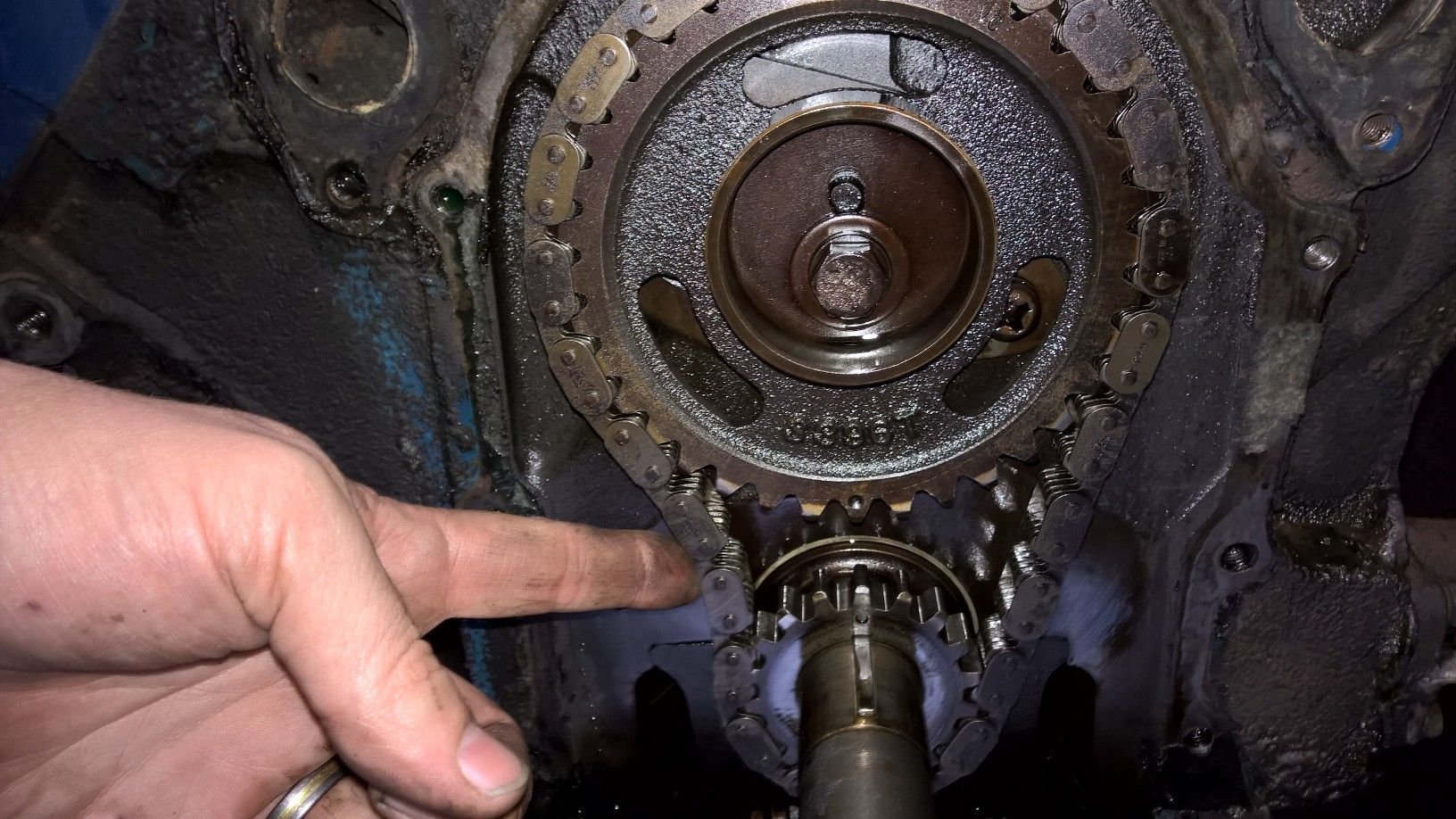

Update: after replacing the carb with a perfect one off Marc's '74 we still could not get the engine to do more than a very rough, low rpm idle, eliminated ignition issues (or so we thought, more on that later) by re-wiring the hot & ground to the coil. Eliminated carb issues by replacing it, eliminated possible plug issues by replacing them. Skilled deduction lead me to one conclusion, Timing Chain. I reasoned this was it because; A) no amount of ignition timing change produced any different result until I got so far off that it coughed & quit B) throttle signal was non-existent, gave it wide open T & no difference C) we had eliminated everything else I could think of. So my son Caleb and I decided to have at it.
Just about down to it..
I expected to see missing nylon teeth from the cam gear; nope, steel cam gear, the chain was Oh Too loose but crank & cam gear timing marks could still be lined up in the vicinity.
This is a really bad shot of the timing chain nearly climbing off the crank gear, one good sneeze and it may have jumped a tooth..

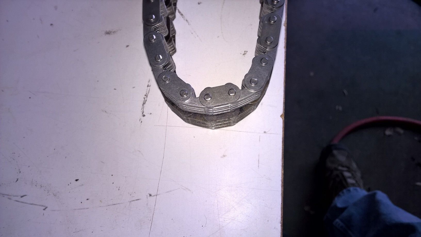

Better indication of T chain play, easy 1"
Though an inexact method of measure, I did my best to align the two chains, old on the bottom, new on top. Perhaps an extra half-link? Combined with the wear on the two gears it was very sloppy and could have retarded valve timing 8 or 10 degrees.
Though the chain & gears were sloppy thus making the cam timing retarded it was still in a place where the engine should have run so we began to ponder anew. Broken cam? Nope, took off the driver side valve cover and valve train was functioning perfectly.
Onward, we installed the new timing set and re-assembled the engine, just over 6 hours after draining the coolant, she was back to form. Took a little to burn the excess fuel from the cylinders as the old carb was just pouring gas but once that was cleared Black Beauty was was back.

Yeah it had me scratch in' my head Mike. God bless the po's pointy little head.
I was really surprised to see the amount of chain slop he had in the timing set.
Maybe one of you out there know if they (Ford) put a steel set in there in 76.
I thought that they were all nylon.
If they were nylon and that is a replacement chain set it is surprising to have that much slop.
