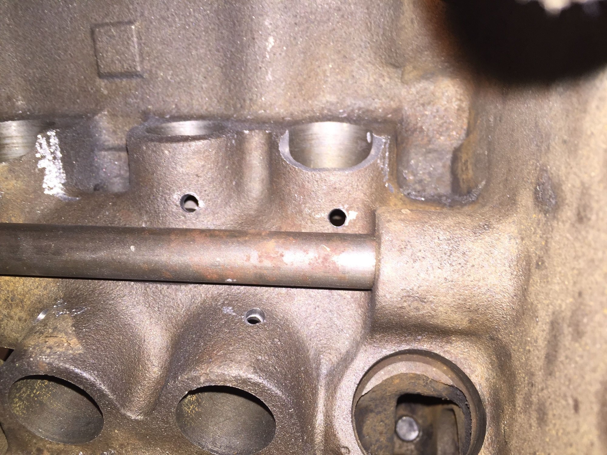

First thing after getting it back from the shop was to do some machine work. I will use Johnson adjustable lifters. I drilled 1/8" holes and used a die grinder and carbide burr on the lifter bores. This will allow a punch or nail to be used to hold the lifter and an open end wrench to be used to make the adjustments.

Lifter
ktgovols,
Why did you knock down the tops of some of the lifter bores in the valley? Also why didn't you continue the relief all the way into the cylinder? I built my first flathead in 1952 and I don't believe I've ever seen anything like this before. What was your reasoning for doing what you did, if I can ask that without being nosey?

Of course you can ask that is why this forum is here!
I machined and drilled the lifter bores to allow a regular open end wrench to be used in conjunction with a punch or nail to allow for easier adjustment of the Johnson adjustable tappets. Otherwise, you have to grind the wrench to get it in. I'm getting older and can't do anything without cheaters in my safety glasses, so it seemed like a smarter thing to do. First time I'd seen it was in Vern Tardel and Mike Bishop's new book (pg 102). I did them all. That pic was to show the difference
The normal flathead relief comes straight down into the cylinder 3/16" deep. In Frank Oddo's book (pg 50) they used the modified relief based on results from flow testing done by Motor City Flathead. It maintains the deck surface and bore rigidity. They also claim it causes the air/fuel mixture to swirl and tumble into the combustion chamber for better application of the expanding forces down on the top of the piston. According to Mr Oddo you also don't lose as much compression as you do with the traditional relief. I figured that anything is better than nothing.
It may all be a bunch of mirrors and flashlights and all for naught, but I figured i'd try it and see how it worked. Opening up and polishing the exhaust ports probably does the most good. They are at least 25 to 30% larger and straighter.

Well, I was out of town for a week, but I'm still slowly going back together. I installed the valves and set the lash. I'm using am ISKY Max 1 cam that calls for the lash to be 0.014" on both the intake and the exhaust valves. The valve lift should be 0.350" for both.
The notches I ground in the lifter bores and the 1/8" holes drilled come into play for this step. The notches were ground to allow an open end wrench to fit in and give clearance to make the adjustment. I still bought a cheap 1/2" wrench in case I needed to grind it to make it fit, but it worked fine. A small punch goes in the hole and holds the lifter stationary while the adjustment bolt is turned to set the lash. I spent a lot of time on these. I could get a 0.014" feeler gage in, but a 0.015" would not go.
Life is a lot easier if you get the first one set, then remove it and preadjust the lifters to be close. The lifter screws are very tight and this is much simpler.
