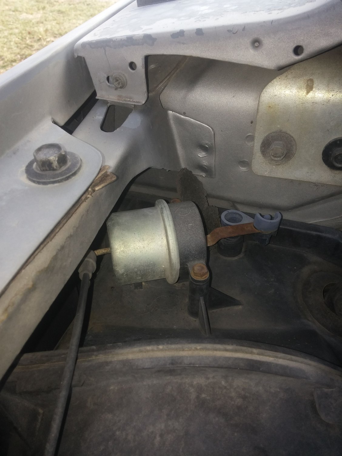

Is this the reservoir on top of the blower case you spoke of? How would i test it? Spray carb cleaner or something around it? Also I would like to replace that plastic line thats on it but where's the other end go? Thanks for the input on this

This is not a reservoir, it's an actuator.

Ok thanks now at least i know what it is does it help with the heat or something? Just asking. Thanks again brother!

resevoir is the big coffee can looking thing between what you shown and the battery. sits on the fender, if previous owner didnt remove it.

Its still there and the solenoid side is capped off because the smog pump is gone thanks brother!
