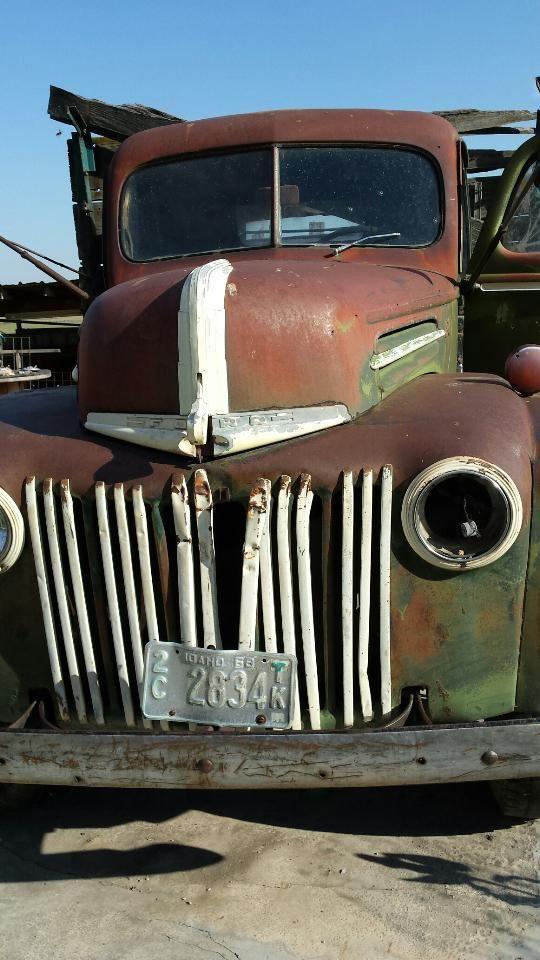

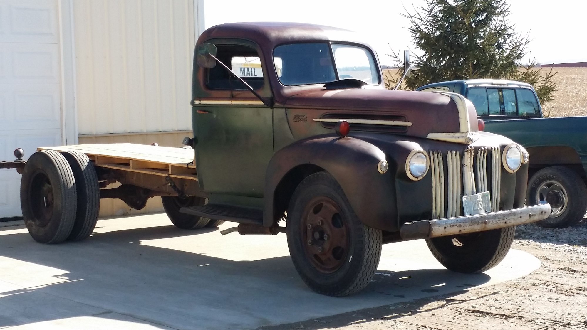

Here are some pictures i got while waiting for it to be delivered in case some of you wanted to see a few more
The old Bed
Before bringing it home
Getting pulled home with my new jeep

Interesting drop sides on the original platform.
Old Feb 24, 2016 | 01:02 PM
parker757's Avatar
parker757
Joined: Jan 2016
Posts: 63
Yea i believe it was bought that way and was used as a grain hauler
