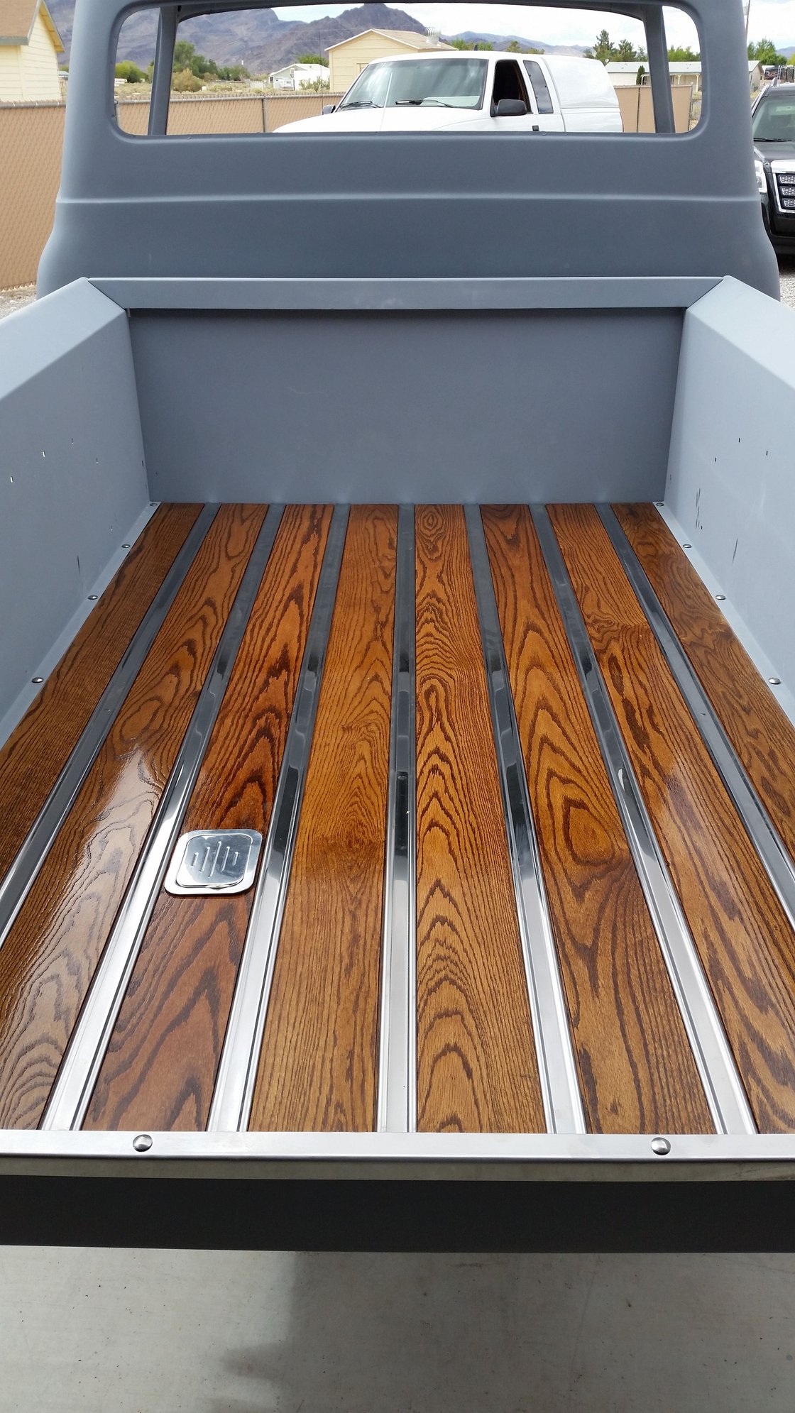

Gas tank relocated
I did mine on my 56 and put marine clear on. I did the top and bottom. Went with polished SS. Hidden bolts on the strips, only bolts that show are on the sides and the end cap.

that's nice, and the look I want, was it a hard job? do the bed sides need to come off of the truck to do it?

I did a frame off so it was easier to get at. I think you would have to loosen the whole bed especially the front header of the bed. Once u get the side slats in the rest is easy. Having a buddy to help lift up on the bed is helpful. I bought mine from Mid Fifty. Mark K. sells them also. I would recommend a good clear that is UV resistant. I think Svolpone is right the end cap towards the tail gate do go under the bed. might have to take off the end cap completely. The after market ones has the SS piece that goes over the top.
