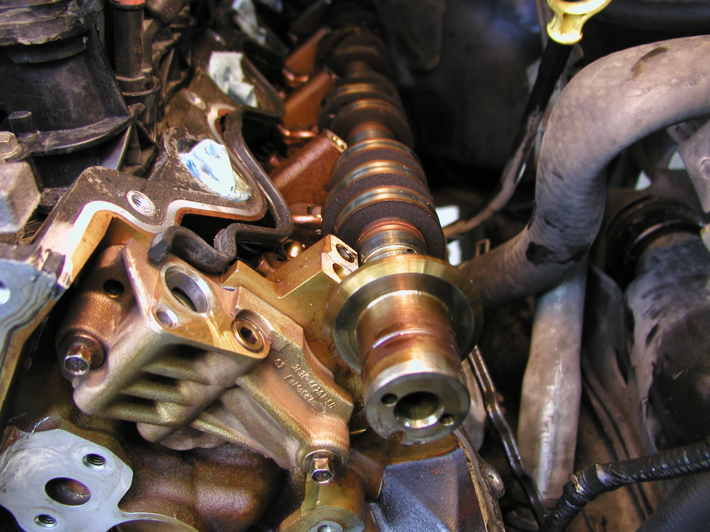

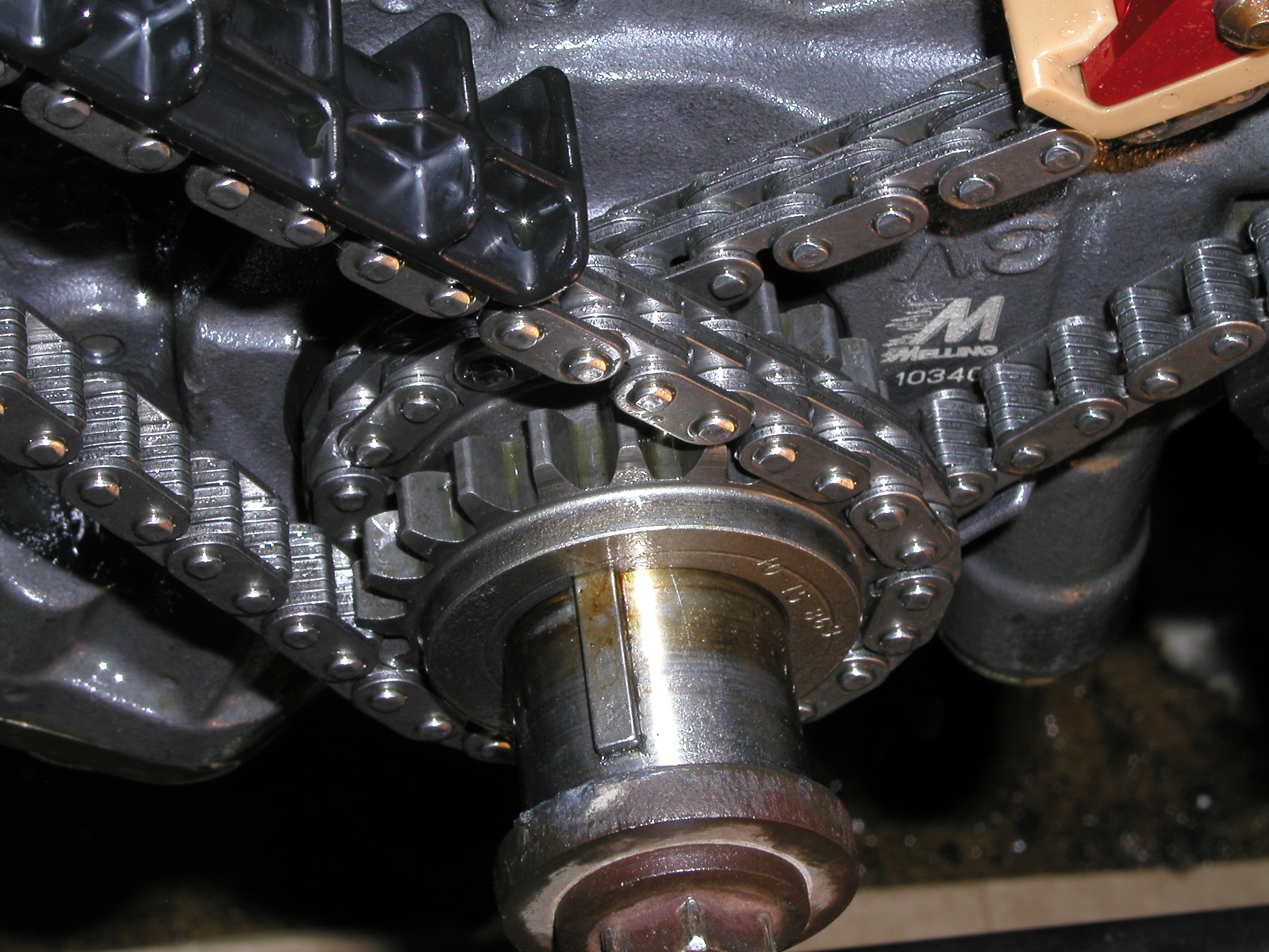

All still fresh on my mind, having just completed a full phaser / guide / chain job, I agree with @flyguy108. I suggest planning on removing the valve cover. I'm sorry for your misfortune - but at least the Bank2 valve cover is the easiest one. Here are a series of photos that I took on my job or have reviewed preparing for my phaser job.
I think the odds are small that it would EVER make it to the pan. But in ANY CASE, I would not even try to turn the engine. If it went toward the firewall under the valve cover - it could interfere with cam follower compressing a valve spring and be VERY DISTRUCTIVE. If it went toward the front cover (more likely I think), there is very little space for it to pass the many obsticals. The timing cover has 'ribs' inside for strength and there is only nominal clearance. Pictures are worth a thousand words.

If it went down the front cover on top of the chain (seems likely), I don't think it can pass between the backside of the phaser and valve body, shown in this photo with phaser removed. The phaser has bolt heads on its backside!
If it wend down the water pump side of the phaser / chain - (I think likely) - I don't think it would make it past the tensioner and tensioner arm. If it's sitting there, any movement of chain could be VERY DISTRUCTIVE. (But the good news, I suspect you could retrieve it from there with the valve cover off - but probably NOT down through the valve cover seal hole.) Here's a photo of that area. you can see my blue paper towel stuffed into the solenoid valve body.
If it got past the tensioner / tensioner arm to the lower side of the chain, it would likely follow the lower chain to the crank gear -- HEAVEN HELP US! I'm not even sure you can get your camera down there with the valve cover off.

right behind the tone ring you have this. If it ever fell down here I think it would get in front of the crank gear.
and the harmonic balancer / front cover seal runs right against the tone ring. Seems to me the odds it could ever make it to the oil pan is TOO SMALL to even try to turn the engine - even by hand.

Thanks for the pictures and advice. It was a 6 inch 1/4" socket extension with a t27 socket taped on (so it would not fall into the engine....). Hope the length will keep it from falling too far.

Thank goodness. I had (for some reason) assumed it was only a 1/4 drive Torkx socket that fell off the extension. If the socket and extension stayed together - you may be able to see it with your camera and snag it with a magnet. Maybe the photos will give you a better idea where it "MIGHT" be.

Cast iron tensioners, Melling oil pump - well done!
