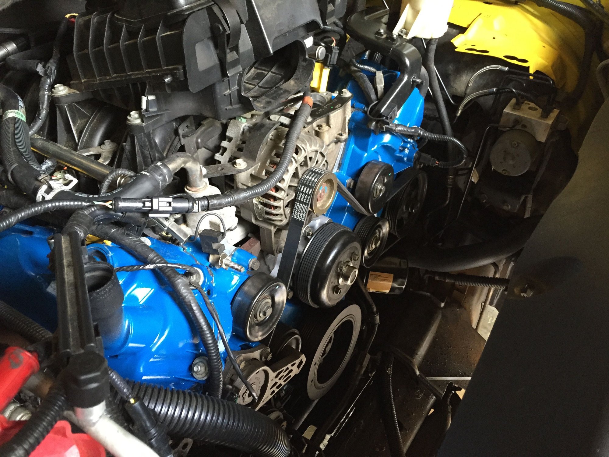

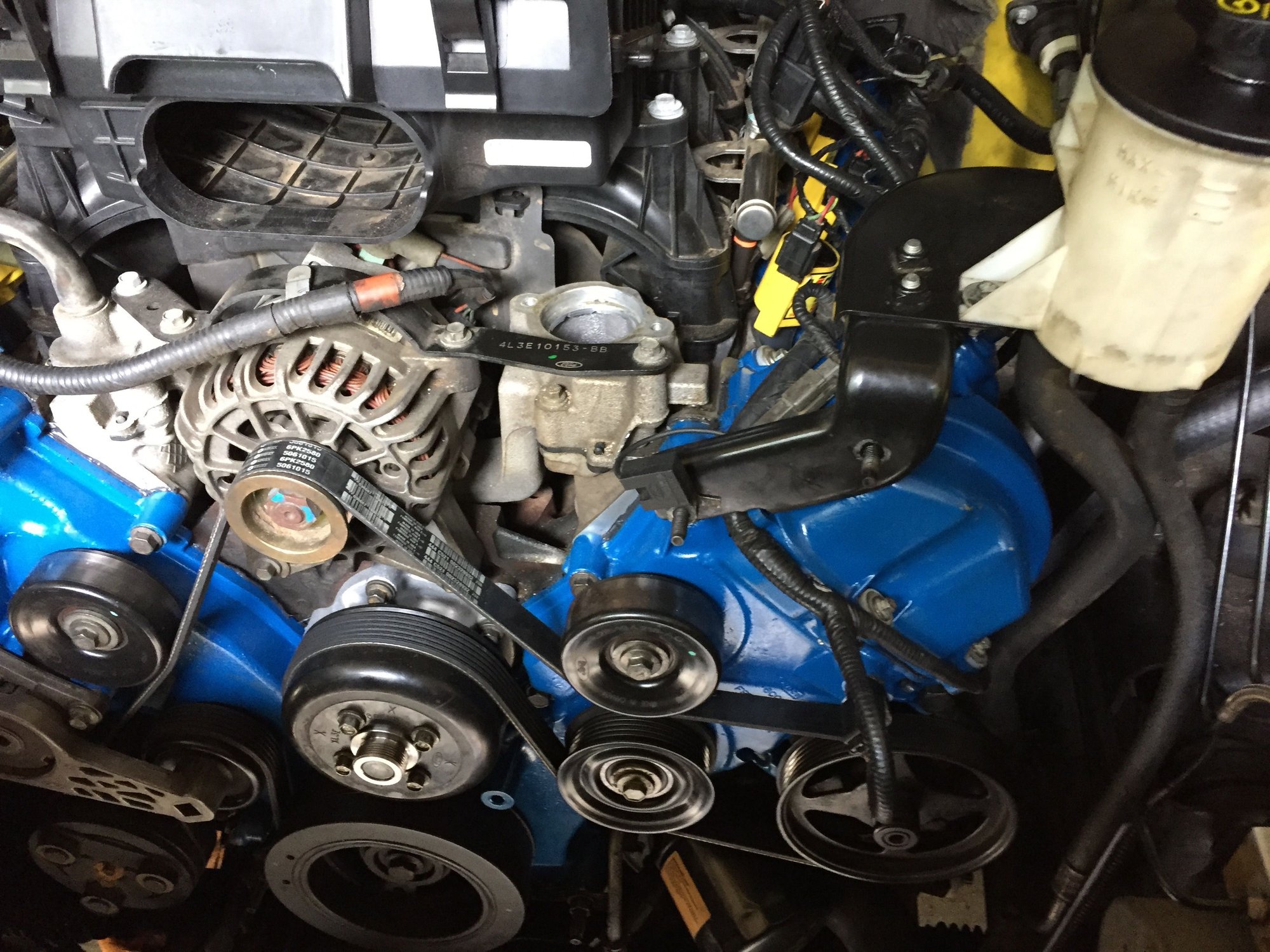

we got the vct's, timing chains, guides, tensioners, phasers and water pump replaced.
cleaned the parts, son wanted to paint them so what the heck? looks good i think.
should have it all buttoned up this afternoon and we'll give it a test run and let you all know.
