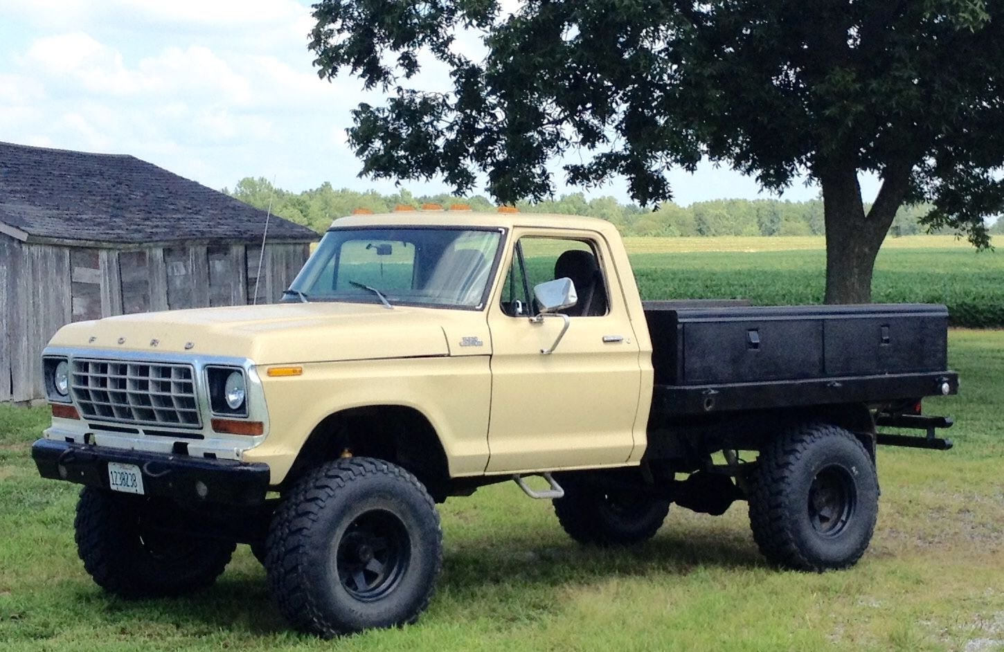

Ok to start I have a 1978 f250 4x4 auto with maybe a 6 inch suspension lift and 3 inch body 4:10 gears and 37 inch tires with a rebuilt transmission but the ford 400 is on its last leg it's beginning to tick and the carbs junk no power at all so I'm thinking of options I'm a welder so fabricating is no problem for me but I have just basic mechanical skills
1. Rebuild the 400 how much would it cost and how difficult it is I'd like to raise the compression if I go this route
2. Swap a 460 I hate buying a engine I can't see run but any that have done this is it very simple? And what are tips to buying a motor out of a truck already?
3. Would be nice to have a cummins diesel either a 4 or 6 cylinder would be great since I plan on turning my truck into a welding rig in the future how hard is it and what are the major parts I would need to pull it off and about how much would it cost?

That is a good looking truck.
