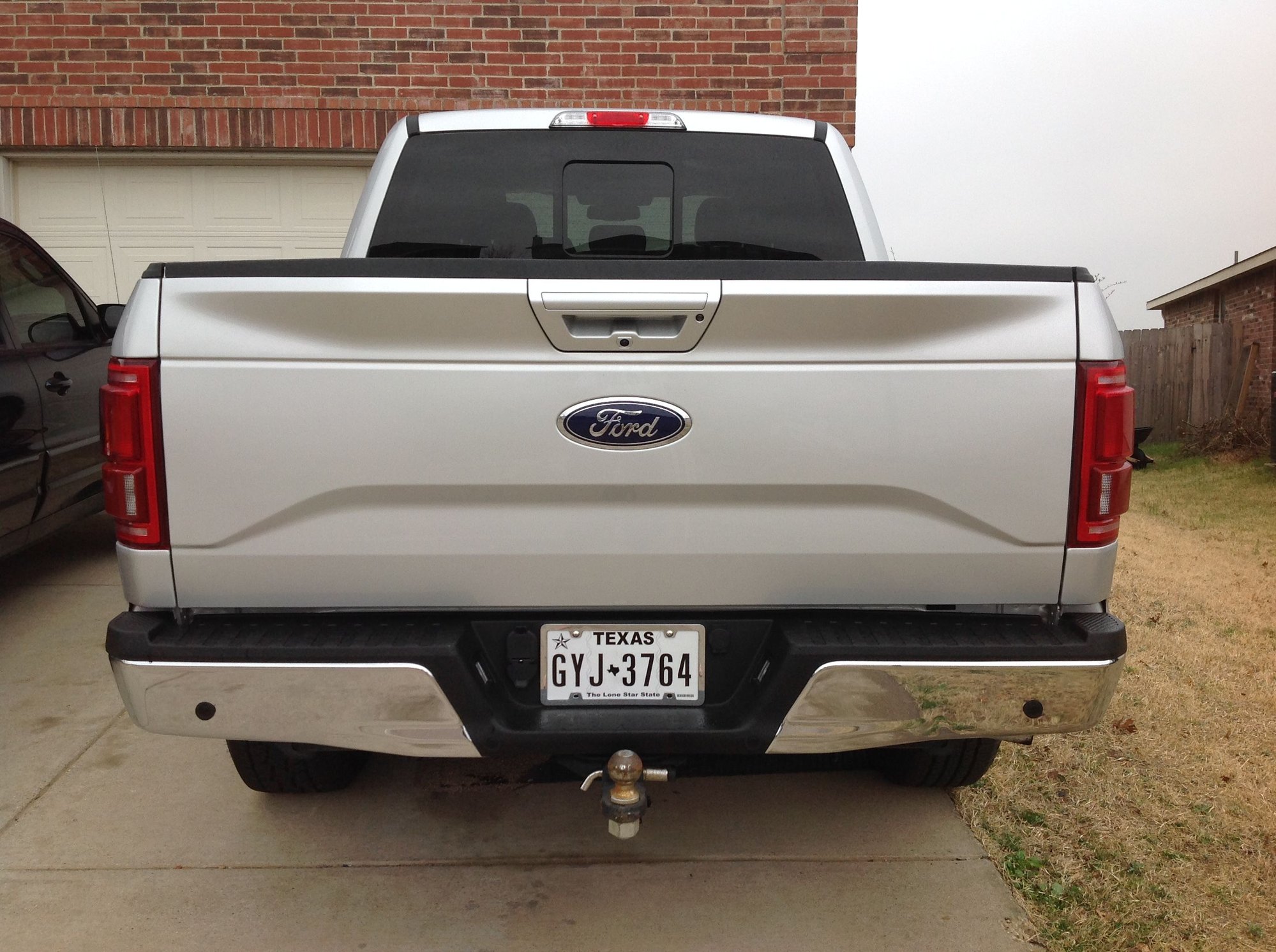

Here you go. Used a heat gun but when the plastic gets hot the chrome part of it came loose from the underside and became useless. But I did just pull it off, using fishing line may give better results. After pulling it off a little WD40 wiped the last bit of adhiesive with no effort.

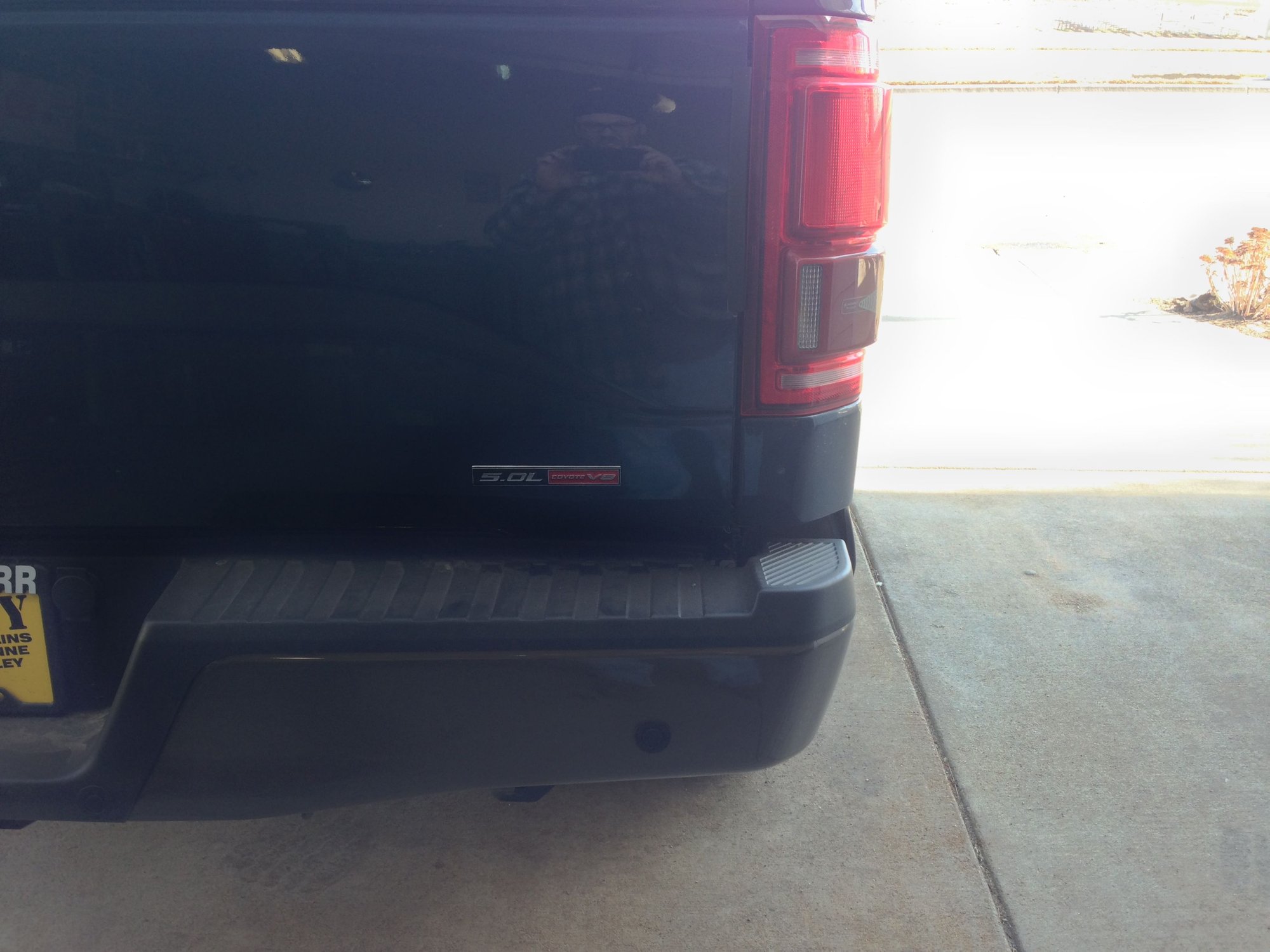

I used a hook pick and snagged an edge and gave the emblem a short tug and "pop!" Off it came.
Added a Coyote badge.

Thank you for the picture!!!

Yes, thanks for posting a picture. That looks great.

Looks good!

did you have the F150 Texas Edition, with the Texas Edition badge on the bottom left below the F150? No holes behind the Texas Edition emblem?
thanks for your picture and resposen.
