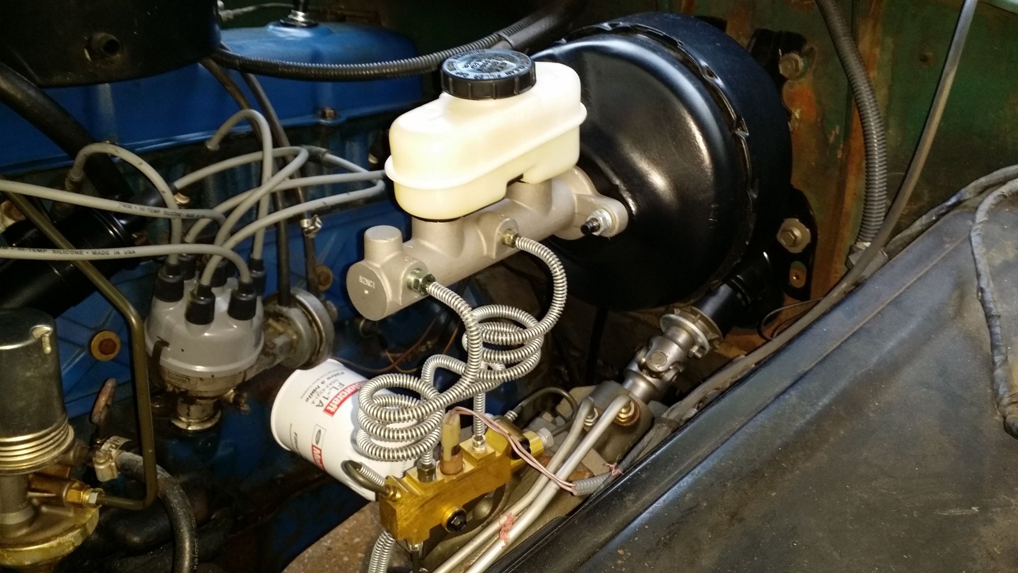

The standard diameter for the hard brake lines throughout the trucks was 3/16". The standard flare nut fitting size for 3/16" hard line is 3/8"-24.
The standard fitting size for 1/4" hard line tubing is 7/16"-24. There are ports in the brake system (some MCs, some brake valves) that have 7/16"-24 flare nut fitting ports in them. Some MCs and some brake valves had 3/8"-24, 7/16"-24, 1/2"-20, 9/16"-18 or 5/8"-18 port fittings. However, these ports did not have 1/4" or larger diameter hard lines going to them. The larger fittings all had the smaller holes in the center of the flare nuts to fit 3/16" diameter hard lines.
The difference in line fitting sizes on the 3/16" tubing was done to keep the lines from being swapped up so they wouldn't be installed into the wrong ports.
As you can see in the photo below, I have (from left to right) a 9/16"-18, 1/2"-20 and a 7/16"-24 fitting installed on a piece of 3/16" brake tubing. The outer diameters are larger than a 3/8"-24 flare nut but, the inner diameters of the larger fittings are the same for installation on the correct 3/16" diameter tubing.
Brake plumbing I did on my truck when I swapped to front discs and power brakes. The MC has ISO metric bubble flare fittings. The rest of the brake line plumbing has SAE inverted double flare fittings.
