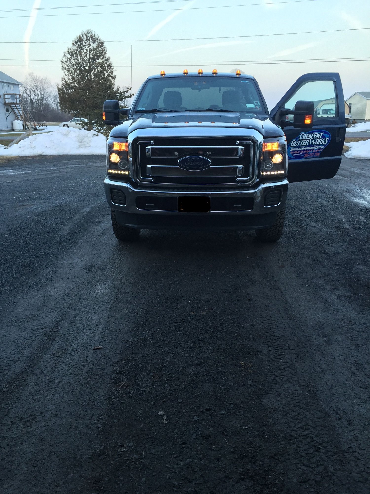

Lights arrived from Amazon today. Installed them when they arrived, already had the grill and stock lights out and waiting.
Might try to post another of what they look like at night. But here's what we have so far.

I got a chance to use them early this morning, as I had to be at work by 4 AM. The high beams are OK. The low beams are terrible. More like fog lights without much forward illumination.
I've written to the vendor via Amazon's website to see if there's any method of adjustment. I don't see an obvious one. If not, they're going back.
