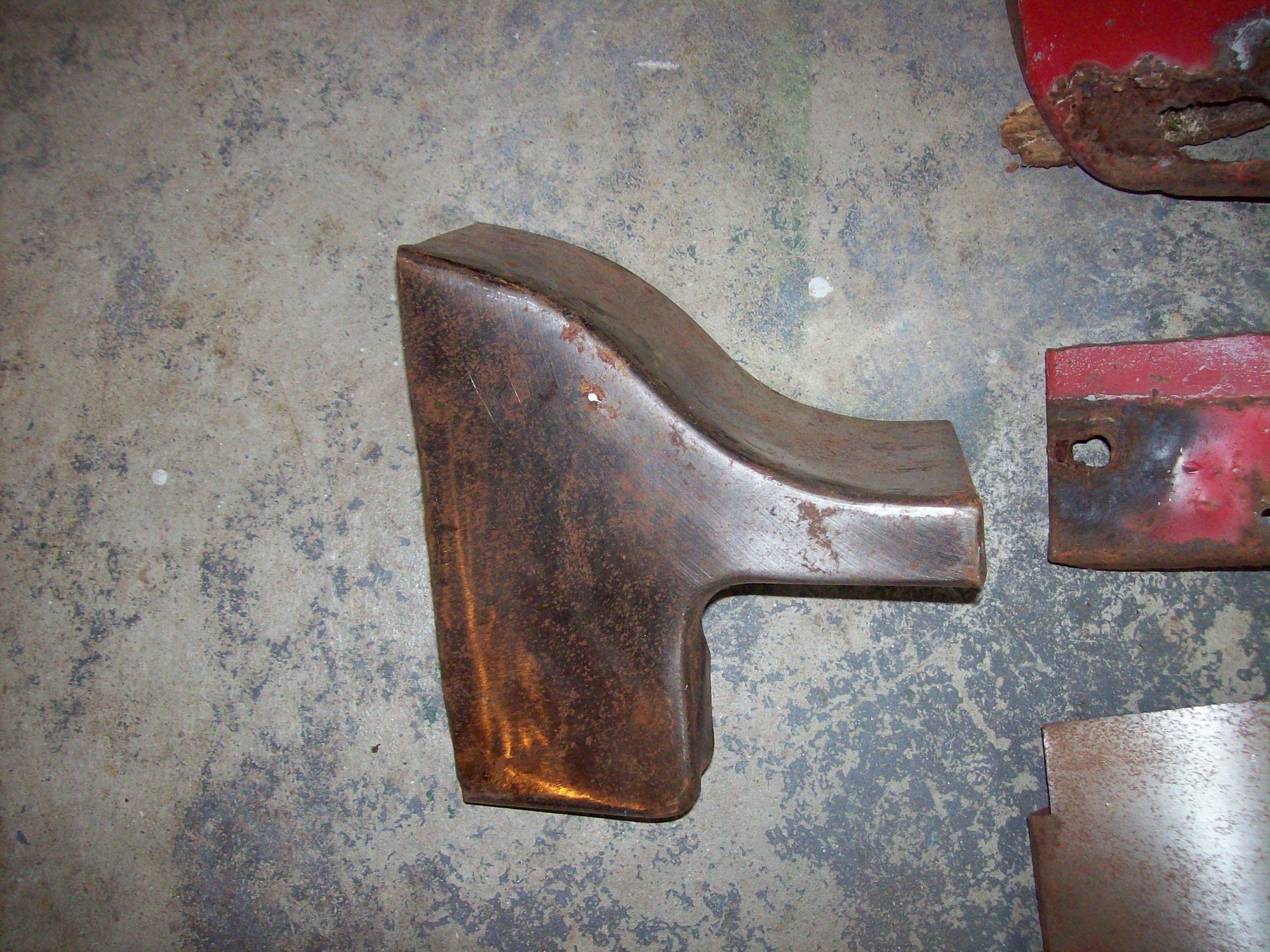

Here's a photo of Fender patch and even the lower fender extender patch.
Patch on the right is for the f-2 through F-8, but it is easily modified for F-1. As mentioned before, Can someone send me a F-1 rusted out section like above?

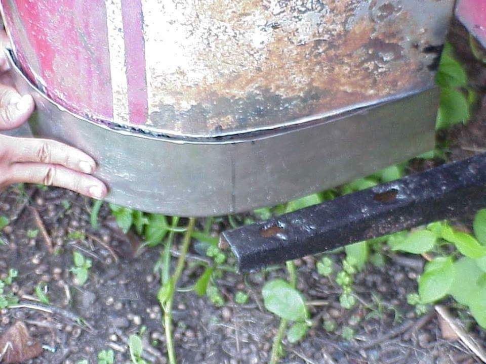

Lower Fender extender patch.

The fenders are the same for F2-6. F7-8 fenders are much larger. The patch you make is a beautiful piece of craftsmanship, but to make it work on an F1 fender it needs a lot more work to modify than you think. I bought a pair and see it will take a complete rework of the panel to fit an F1. The inner brace needs to be cut out, the outer cut in half and a filler piece welded in, and then the inner will need to be remade and reinstalled. For me, it would be simpler to make one from scratch rather than modify those. If you could make a specific F1 patch, that would be wonderful.

I have had many F-1 users make the mod by Cutting vertically by the 90 degree bend and add a straight piece of sheet metal.
I am looking for a section of an F-1 to make new dies specifically for the F-1..
Mine was an F-5.
