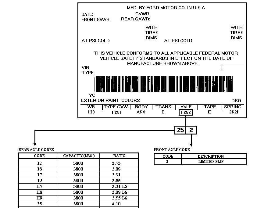

Back to your original post....3.55 is the most common gear ratio for this vintage truck with a 5.8L and E4OD. Have the seller get you the axle code from the driver side door jamb sticker.
This may help:
