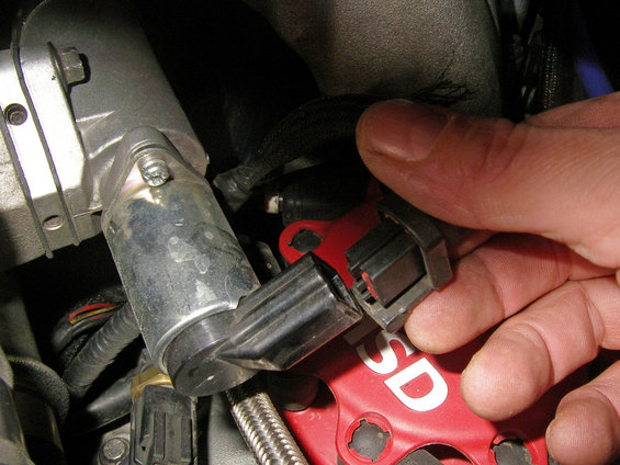

it sounds like you have a dirty idle air control valve.

depends on the engine. what i do is remove it and clean it out with throttle body cleaner. spray it in and shake to loosen the carbon buildup, then pour it out. i do this until the liquid comes out clean.
depending on how many miles on the engine, i also remove the throttle body and clean it with the spray and a toothbrush.
i usually clean the throttle body every 50k miles or so.

IAC is on the side of the throttle body. held on by two bolts. you want to remove the two bolts going into the throttle body, not the two screws that hold the solenoid to the valve.
