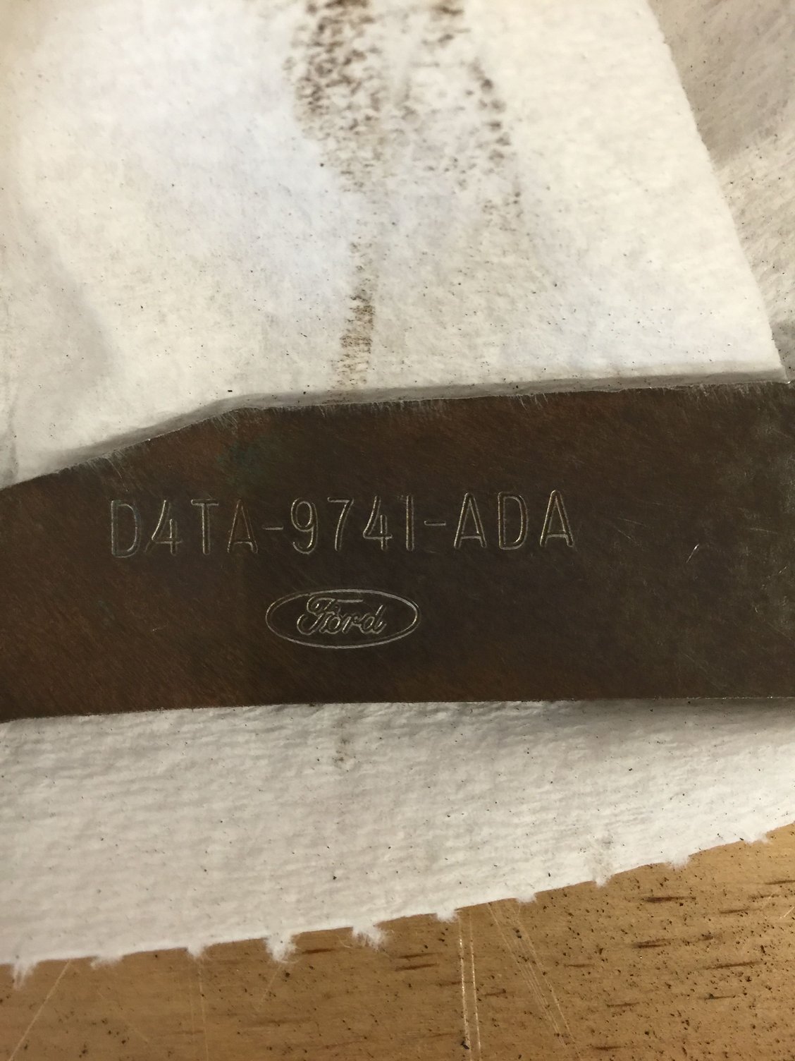

Numbers on throttle bracket.
Old Feb 13, 2016 | 07:16 PM
SirBunnyEater's Avatar
SirBunnyEater
Joined: Feb 2016
Posts: 12
Not sure what they are and where to decode them. Thanks for any help.
1974 F600. I think she's got a 330ft. Clark 5 speed?

That is the throttle return spring bracket.
D4TA-9741-ADA
The first 4 digits are the decade, year, platform, and engineering division.
D=1970s, 4=1974, T=Light/Medium duty, A=Ford
The main part of the number identifies what the part is.
9741=Throttle return spring
ADA
The suffix usually indicates the revision level of a part and sometimes designates left or right and sometimes color. I believe longer suffixes can also indicate an assembly.
A=Original design, D=lower, A=I'm not really sure in this case
Hope this helps!
