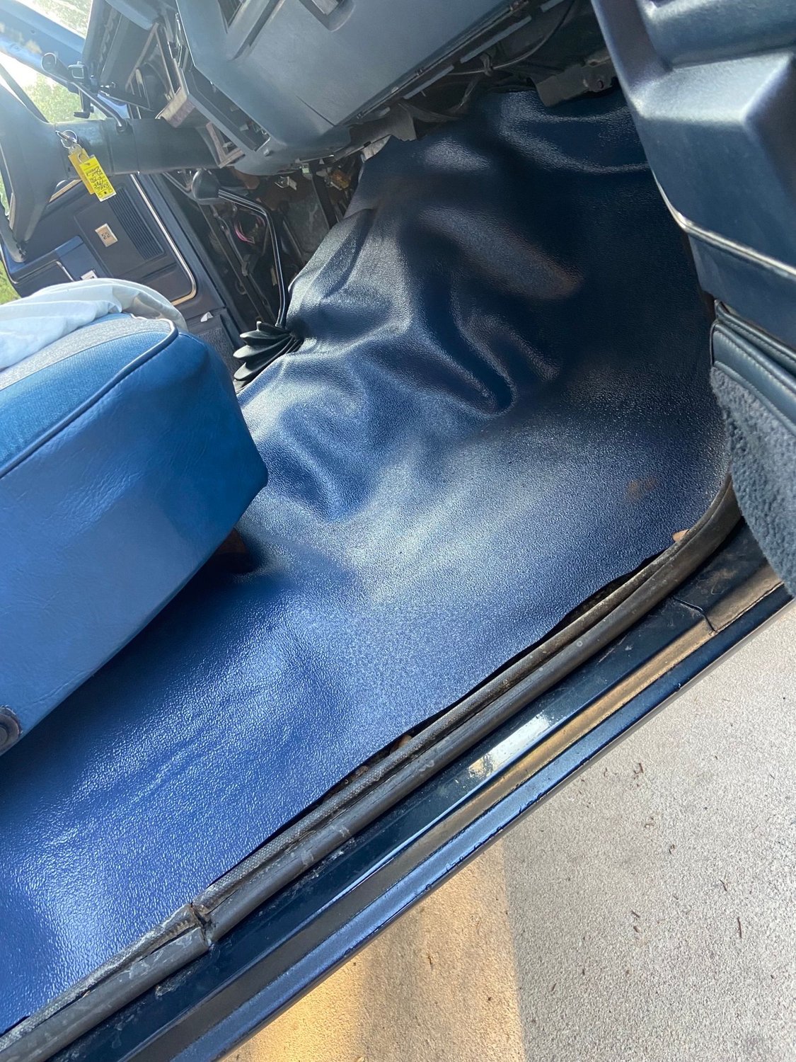

Man!!! do I wish I would have done a search to find this post PRIOR to donating money to ACC. I googled videos of how to install their product and there were tons of them of course, but only the successful effortless ones. Suspect, right?
I sent these pictures to them suggesting their form is not correct for the yr,make,model that was sent. They replied, based on the pictures, it is the right one and implied it was my skill level that was the issue. ha? I guess I could try watering the trans tunnel for a few days and see if it will grow into this flooring.

You would thinks after all these years the would get their act together! Not. A friend of mine recently bought a trunk mat for a 69 Super Bee. Fit like crap. Contacted ACC and told him that the 1/4 panels were not installed correctly. Its an all original car with original 1/4's. He was charged a restocking fee.

This is pretty common. I've worked in auto body and interior shops and have never done an aftermarket carpet that actually fit without some work. The edges usually need to be trimmed so it lays flat and fit's under the door trim/dash/rear seat/panels/etc then the holes will need to be opened up with a razor if they don't line up exactly. Once it's fitted, it'll take a couple weeks of use/heat for the last little wrinkles to settle out. Fold the edges back 6-12", center it in the cab and work from the center out trying to get it to lay as flat as possible. when you get to the edges, trim as much as needed to get it to lay flat and still fit under and Dash/trim/etc Then go back and slice it anywhere it need more clearance around holes/brackets/etc.

Shameful, right? I sure hope the word gets out so more people know before wasting their money. I did several ACC searches before I ordered mine but never thought to add "issues", "trouble" or "problems" to my search. Google must have a way that so it doesn't pull up anything bad unless you are looking for the bad. I encourage all of us to post, comment and add youtube videos showing how poor their products are to educate others before it's too late for them as well. Thanks for the confirmation that I am not alone.
