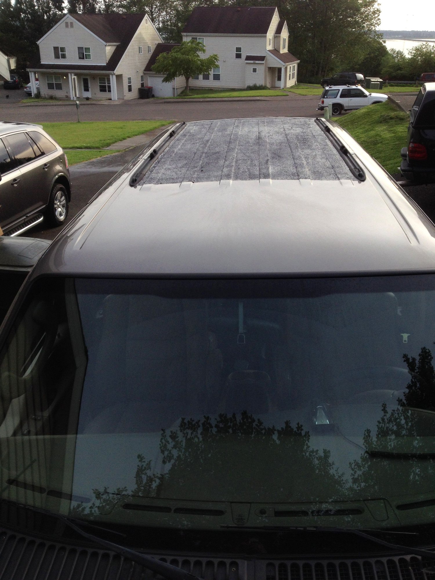

I did a simple do it your self roll one liner from the local auto store. The previous owner had torn up the paint and there were a few sports with bare metal showing. So I scuffed the thing up and went at it. It is now showing a little ware, and will need another coat this next summer, but it has worked great so far, and I have not noticed any increase in the heat level of the Ex.
Here is a pic or two or three:

If you get it professionally done you can always get it done in white if heat is an issue. Also, USCG that looks AMAZING!

Thanks USCG! Exactly what I was looking for! My Ex is red, but I think black would look good on it.

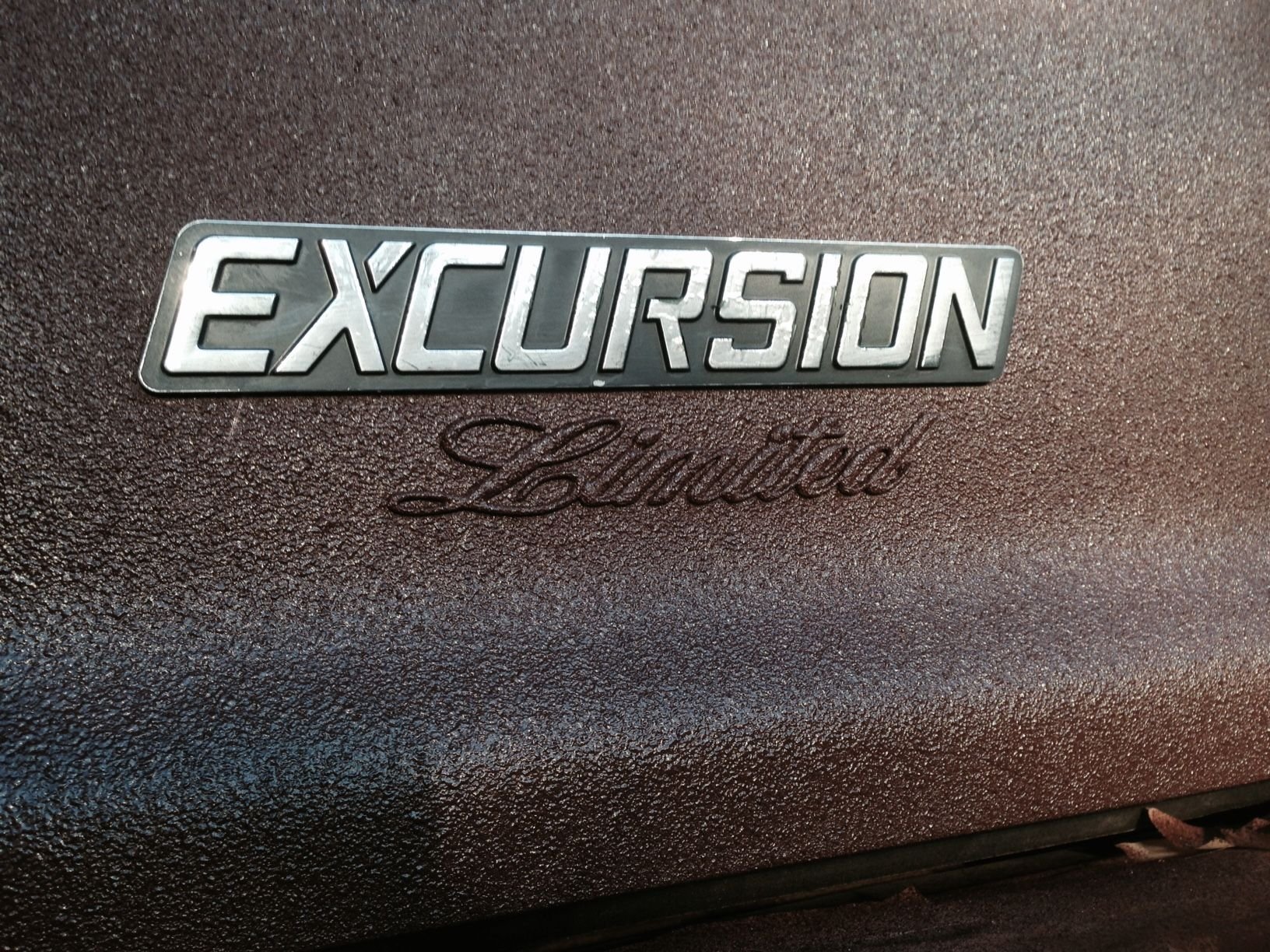

Don't get too carried away.....
Prepped with 60 grit, then acetone for cleaning. <br/>
I wouldn't hesitate to do my roof. I would probably opt to spray it with Raptor. It's pretty straight forward and is hard as a rock. It's all in the prep. Get lots of compliments, second glances.
