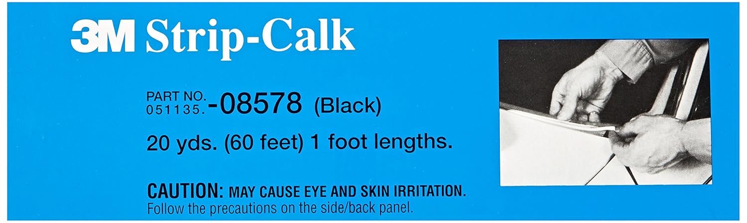

Make sure you get a small roll of Butyl tape. If and when I sell a set of trim, I try to include enough tape to do both doors.
The thinnest I have found was 1/16" If this is still to thick you can flatten it.
A small piece on each clip does the trick, no rattling no loosing clips.
White Trimmable Butyl Tape Putty Tape White 1 16" x 1 2" x 45 5820 S | eBay

gangstakr; appreciate the information! Not sure if same/similar to product mentioned, I have an excess of the 3M spaghetti thin stick caulk that I placed around each of the clips, did not use much but perhaps enough to prevent the clips from fully seating; I assume the original clips have lost their spring capability? When I removed the door panel I found a similar type product was used, intend comparing the two for the easiest application, now just a matter of waiting for the clips.
http://ecx.images-amazon.com/images/...L._SL1500_.jpg
Again, I thank you for the info.!!
