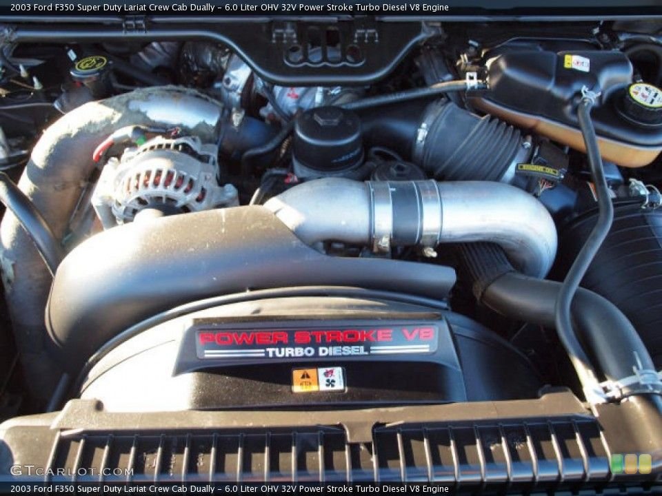

On my 2003, The hot side of my CAC pipe came stock with fiberglass insulation. It was falling apart and previous owner had wrapped electrical tape around it to hold it together. that side is all aluminum on mine. I scraped it all off, sanded and polished it up and made sure it wasnt touching anything that would melt. dont know about the later years but Ford thought they needed it for a reason. pic I found online..

I have never seen an OEM CAC tube that was metal and wasn't aluminum, so no they will not rust. The only other material was the plastic cold side they changed to.
