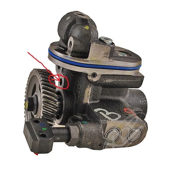

Alright took off the Hpop cover and screwed the IPR valve back in to keep air from coming out...
What i found was a bunch of air rushing out of this hole in the picture...

Also their was little to no oil inside the Hpop was pretty dry inside.. I did put my finger over the hole to plug the hole and herd little to no air coming out.. i Did look at the STC fitting and it seems to be fine.. no air and no bubbles coming from or around the STC fitting..

The IPR is normally open, you'll have to energize it to close it, I believe that hole is where it discharges excess pressure. This second generation style pump rarely fails. On the T shaped fitting coming off the pump, does it have a plastic section in line with the gear or is it smooth pipe like the one in the picture?

its like the one in the picture..
But my question still stands does the Hole in the picture mean anything? its the Red line pointing to the hole i found air rushing out... is this normal???
Im only asking to better understand the truck that i drive and work on.. Im not trying to offend
Some people say if its working right you will hear a very slight air sound.. but this is like night and day

The low pressure oil pump is in the timing cover, behind the harmonic balancer. Not too hard to work on but you do heed a special puller to get the balancer off. What you are looking at is the high pressure pump. The IPR (mounted right on the pump) is normally open, allowing much of the pressure and volume to bleed off like you are seeing with the air. When the PCM commands more high side oil pressure like during high throttle/rpm/load situations the IPR closes (increases duty cycle) closing the valve more and allowing less oil to come out of the hole and bypass the injectors. Low side oil pressure is less than 100psi, the pressure of the pump in the picture can be as high as 4,000psi.

Yup, IPR is spring loaded to open, electrically driven to closed.
It is a loop in a way, low side pump pulls oil from the pan and in addition to lubricating the crank/rods etc, it fills a reservoir cast into the engine block in the front of the "valley". High pressure pump pulls oil from that resivoir and sends it to the injectors as need and vents the rest out of the hole on the side of the pump, where it drains back into the oil pan by gravity.
