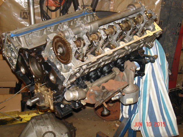

I wish I would have taken better pics now. Like I said I used some random 10mm headed (believe the thread pitch is 6x1.25) bolt that was the right length and threw it in. The bolt was from some honda I parted out and did have a small shoulder on it. Nothing special on the cam caps for the bolts.
You can barely see it in this pic, it is at the top middle of the balance shaft/cam cap.
Attachment 289411
Old Feb 9, 2016 | 07:29 PM
topscrt's Avatar
topscrt
Joined: Feb 2006
Posts: 258
From: cleveland, ohio
great pic. Thank you Snowseeker
