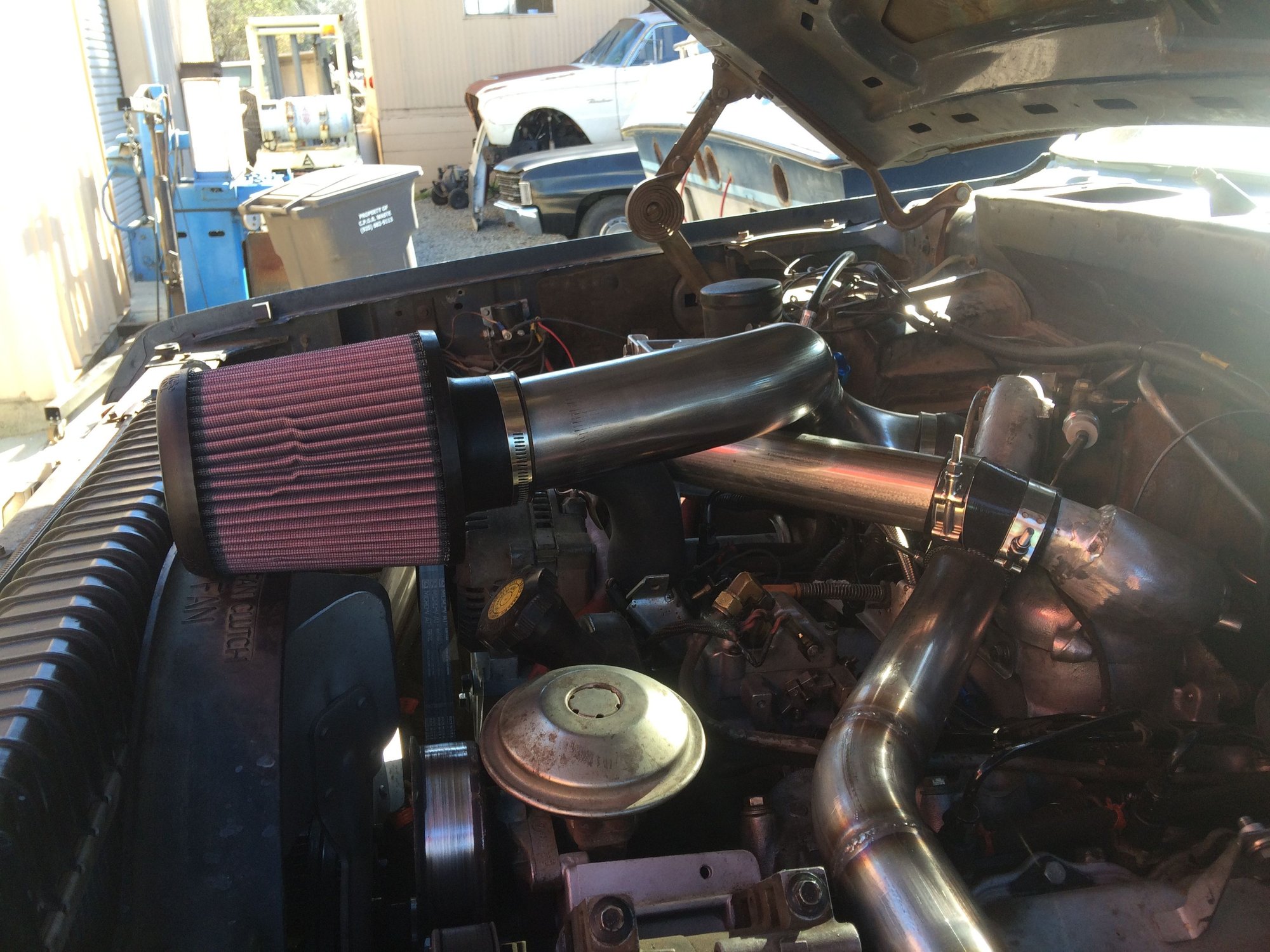

i used a 1000 cfm inner cooler, and deleted my AC.
spent 150 on the IC, and about 100 in clamps and boots.
i purchased mandrel 2.25" u bends from summit and made my own charge pipes.
for under 400 bucks it was done.
i also welded a piece of aluminum pipe to the turbo hat

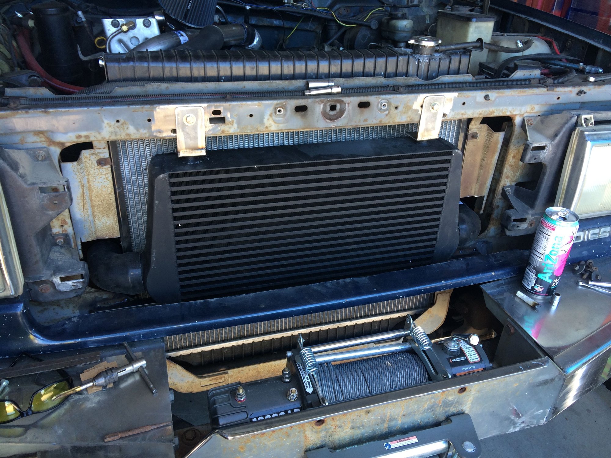

Universal Lightweight Aluminum Turbo 31"x12"x3 25" Fmic Front Mount Intercooler | eBay

Lots of guys have installed intercoolers without deleting the AC. The IC is mounted in front. It's s tight fit and the 83-86 body style requires trimming the grill fins or going to a thinner billet grill, but it fits. The 7.3 SuperDuty units are more commonly used than the 6.0 units and are easier to fit. If you choose an aftermarket one be sure it is wide enough to straddle your radiator.
