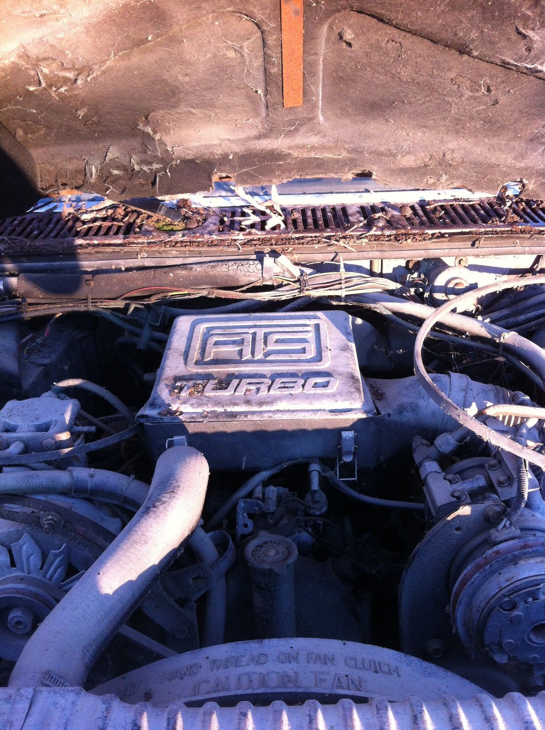

Anyone know the sufferance between these two turbos? Im
sure one is later

Top one is the 088, I have that one myself.
Don't know the second though. Edit: I see it is waste-gated so it's definitely the later turbo.

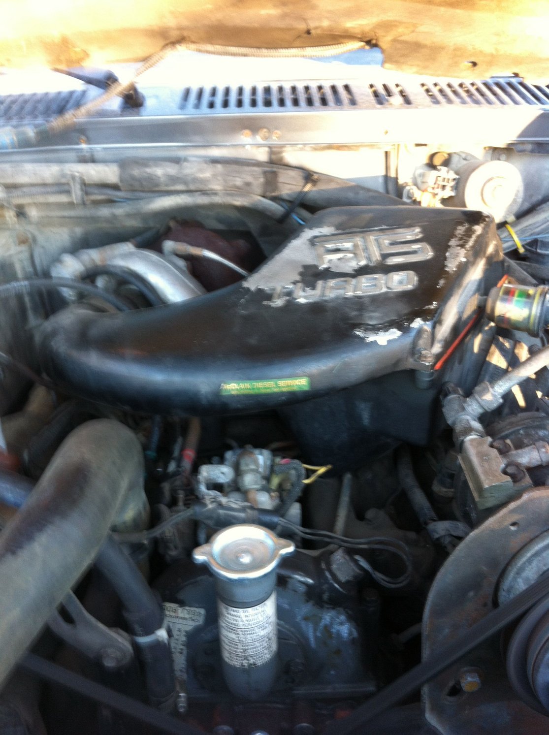

093 i believe

Yes, the second one is the 093, same as the factory turbo option but with a better down pipe.

Witch one do you guys think is the better one? The top photo is of one on a truck that I just bought,for the turbo (bad engine) the lower one is on a friends

The 093 is the better turbo. Banks makes a down pipe upgrade but iirc the ATS version of the 093 had a DP that was just fine.

The factory 093 turbos have the squashed dp and smaller turbo outlet, but also say Ford Turbo on the air cleaner. The aftermarket 093 kit has the air cleaner in the picture, and has a 3", not squashed dp.
